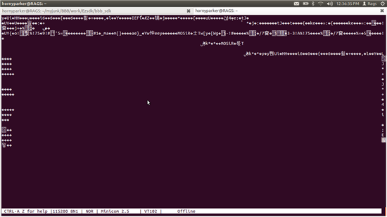

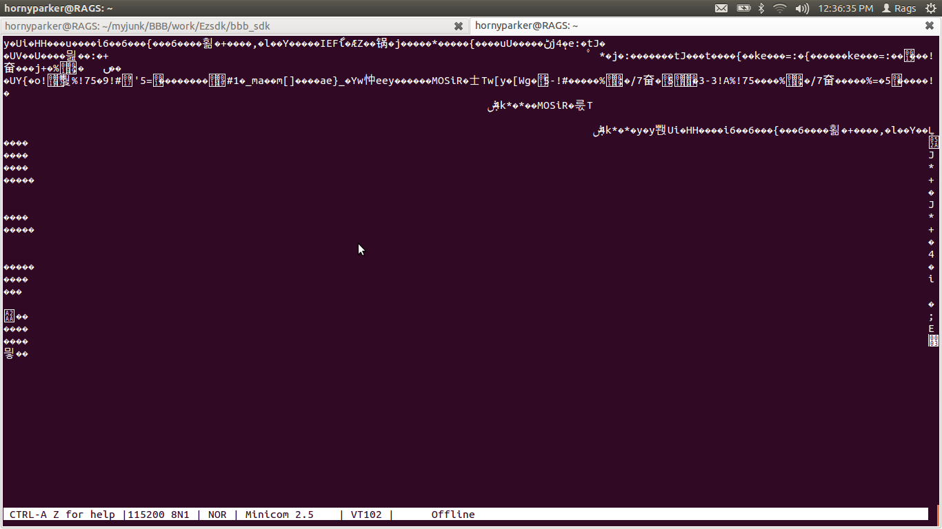

  • Hi There all developers,
    I am using BBB revision A5A, I am following the posts and ended up with some junk characters on minicom console
    FYI: using "ti-sdk-am335x-evm-06.00.00.00-Linux-x86-Install" provided by TI
    minicom setup details are as follows:
    A -    Serial Device      : /dev/ttyUSB0
    B - Lockfile Location     : /var/lock
    C -   Callin Program      :
    D -  Callout Program      :
    E -    Bps/Par/Bits       : 115200 8N1
    F - Hardware Flow Control : No
    G - Software Flow Control : No
    presuming baud rate is the problem, i have tried with all the combination of baud rate and ended up with same result ( junk characters)
    output on minicom console :
    attached files are the output of minicom
    Kindly someone help me out from this!!!
