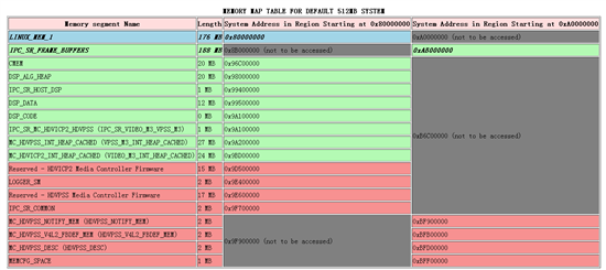

512MB DDR,omx demo can't running
I have a dm8148 board with 512MB DDR3,and I modify the files mentioned in the EZSDK_memory_map,then rebuilt all,
But when the board boot up,I running the omx demos ,it come to nothing.

why it say "no data for read"? And the HDMI screen have no reaction,no data input.
Anywhere should I to modify?

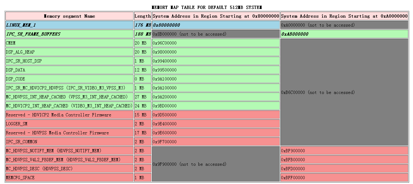

    I do not see errors.
    Could you double check the memory map ?
    Follow:
    http://processors.wiki.ti.com/index.php/EZSDK_Memory_Map#Changing_Memory_Map_For_512MB_DM814x_Board
    Margarita
  • Margarita,
    I have checked the memory map,I had do what the setps refer to the memory_map gudie.

    But in the memory map guide it was
    Enson
  • There are a lot of difference between them ,should I modify it?
