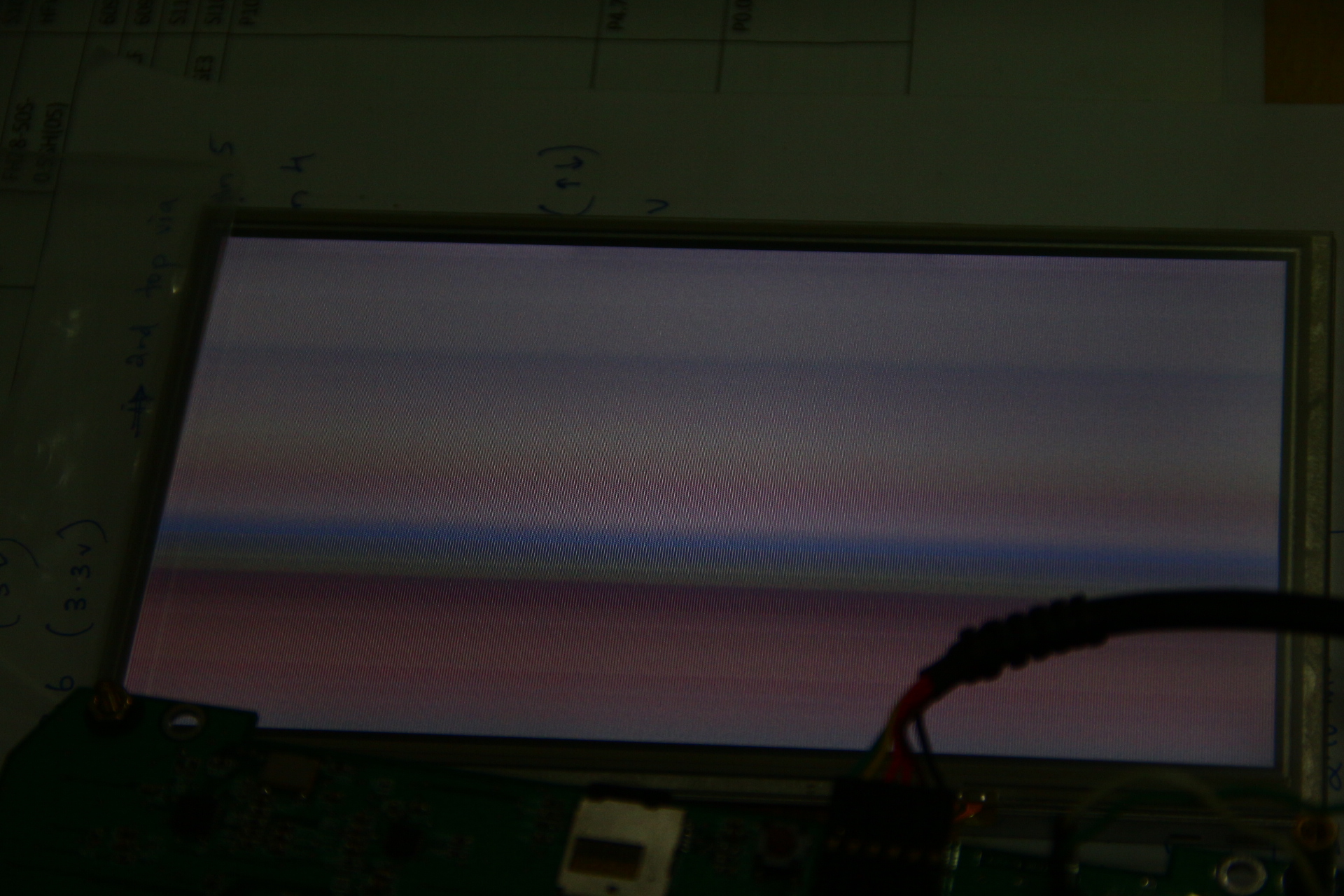

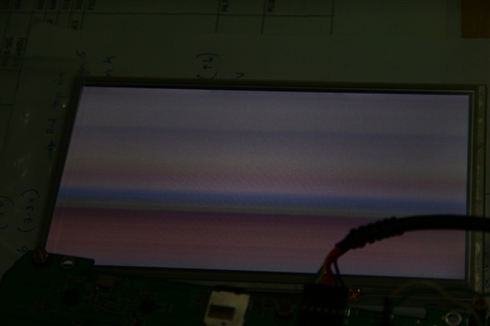

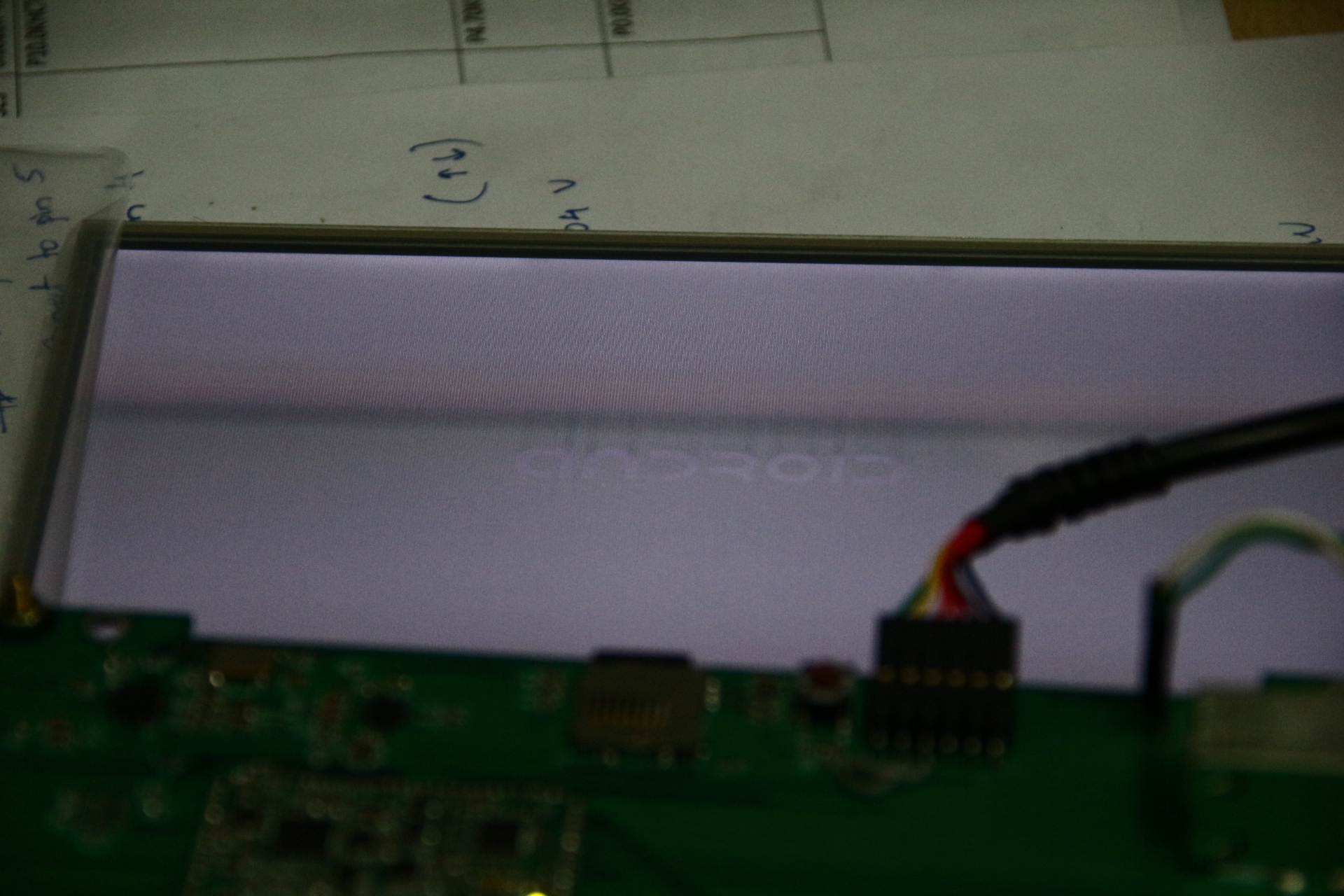

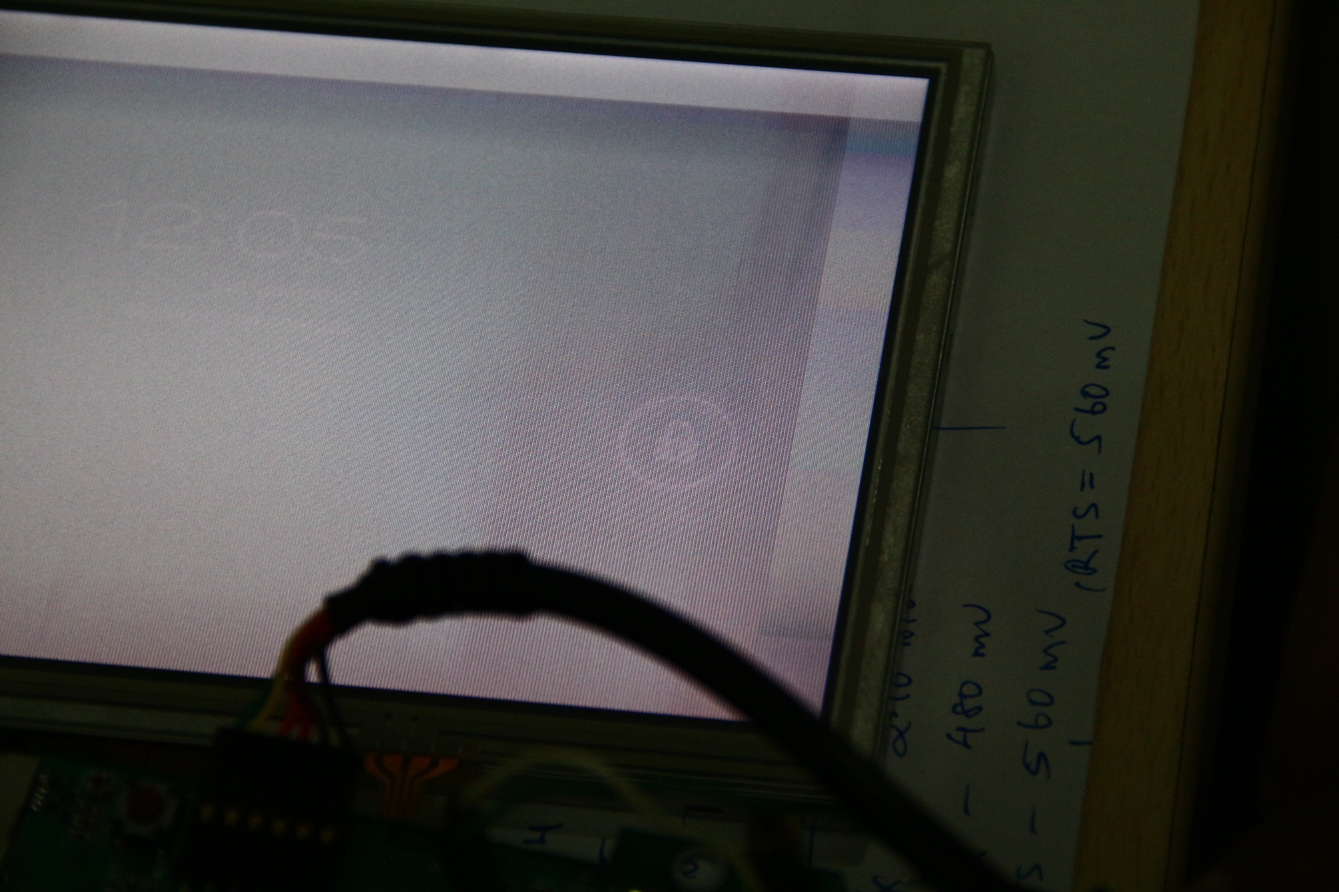

We are interfaced AM335x Interfaced a 24 bit LCD.
According to the Sprz360e.pdf our connection is like 16bit. so other bits are we put low through software.
When we loading the Android or Linux both are loading and screens are coming, but no colors we couldn't see.
White light is we can see only.Under the white light we can see the booting screen and menus all thing.
when no data s coming the LCD screen is constant and no flickering. when data s coming screen flickers and through that flickering only we can see the menus and screen.
We tried with RED signals only. But still a white shade is upon the red color.
Also please check the images.
Any one feels the same problem ?
Could any one help?
