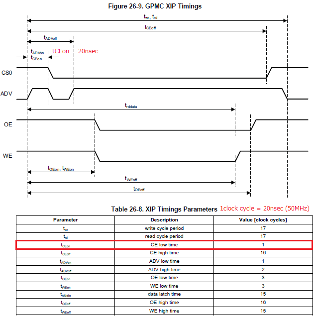

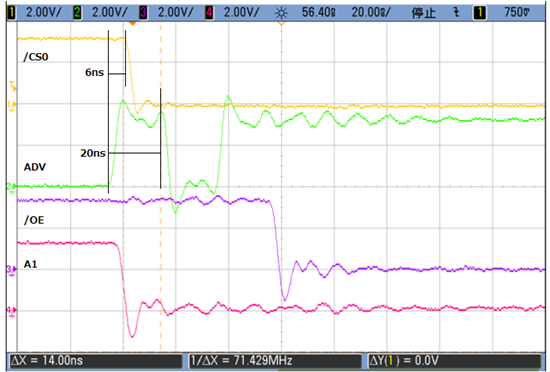

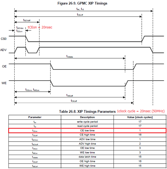

I measured GPMC XIP Timing on TMDXEVM3358.

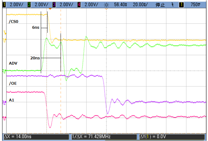

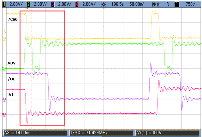

The /CS0 wave is different from TRM definition.
Question:

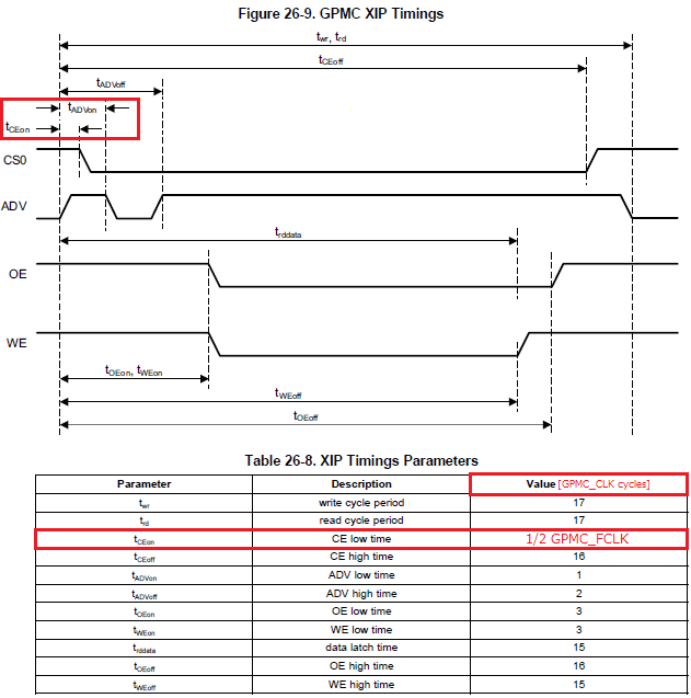

 - I think tCEon = 0.
   How do you think about this? (Is this typo of TRM?)

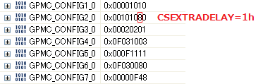

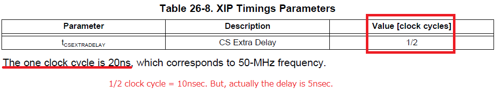

 - How do you think about 6nsec delay existing on the /CS0?
my setting is :
  SYSBOOT[15:0] = 0100000100011010b
TRM description:
Actual wave:
