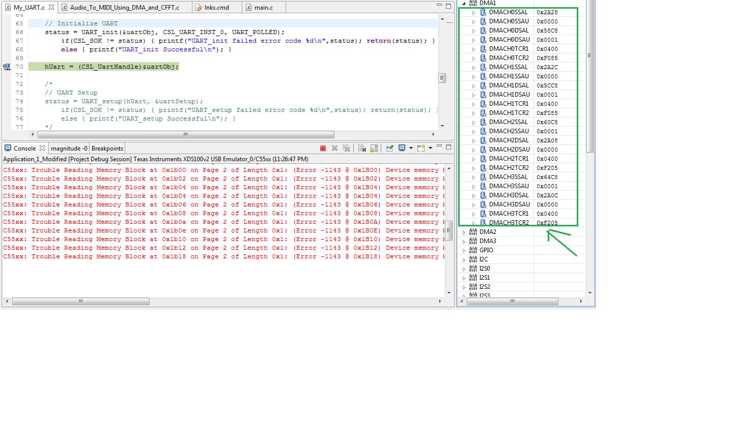

    I tried to check the value of the UART registers in the CCS IDE before i even started adjusting UART register values, and the following is a sample of the errors I get in the console:
    C55xx: Trouble Reading Memory Block at 0x1b00 on Page 2 of Length 0x1: (Error -1143 @ 0x1B00) Device memory bus has an error and may be hung. Verify that the memory address is in valid memory. If error persists, confirm configuration, power-cycle board, and/or try more reliable JTAG settings (e.g. lower TCLK). (Release 5.0.429.0)
    C55xx: Trouble Reading Memory Block at 0x1b02 on Page 2 of Length 0x1: (Error -1143 @ 0x1B02) Device memory bus has an error and may be hung. Verify that the memory address is in valid memory. If error persists, confirm configuration, power-cycle board, and/or try more reliable JTAG settings (e.g. lower TCLK). (Release 5.0.429.0)
    C55xx: Trouble Reading Memory Block at 0x1b04 on Page 2 of Length 0x1: (Error -1143 @ 0x1B04) Device memory bus has an error and may be hung. Verify that the memory address is in valid memory. If error persists, confirm configuration, power-cycle board, and/or try more reliable JTAG settings (e.g. lower TCLK). (Release 5.0.429.0)
    Here is the image trying to read the UART registers, which is unsuccessful:
    Here is my attempt to read the registers for DMA1, which IS successful:
    Basically, the emulator cannot read from any of the UART registers without giving an error, but reading from other registers works fine!!

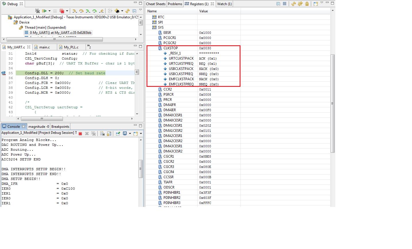

  • Thanks for the reply Pratap -
    Hereis a snapshot of my CLKSTOP Register at a break-point that is before I modify any UART registers in my code.
    The CLKSTOP register value is 0x0030 which means that URTCLKSTPACK and URTCLKSTPREQ are both set to 1.
    It seems that when I "Reload Program," and my program counter is at the start of "main.c", the CLKSTOP register has already been set to 0x0030. I thought this could mean that the setting of the URTCLKSTPACK and URTCLKSTPREQ bits happens in the GEL file I am using - but I looked at my GEL file and it does not set the bits. I do not know where or why these bits are getting set in the CLKSTOP register. I will try setting them to 0 before I modify any UART registers and report my results here.
    Thanks!
  • Set the value of 'URTCLKSTPREQ' bit to '0' before configuring UART registers. This will enable access to UART registers.
    - Pratap.
  • Thank you so much Pratap!!!! That worked for me. I do not know where in my code those UART CLKSTOP bits were being set, but adding the following code worked for me:
