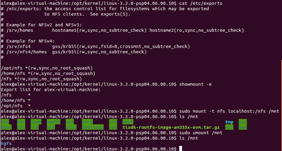

Hello:
my host computer: Ubuntu12.04
Kernel:linux-3.2.0-psp04.06.00.10
I confiremed that NFS and TFTP service are normal.
I got the source code  ti-sdk-am335x-evm-05.07.00.00-Linux-x86-Install from http://software-dl.ti.com/dsps/dsps_public_sw/am_bu/sdk/AM335xSDK/latest/index_FDS.html,
then following the instructions http://processors.wiki.ti.com/index.php/AMSDK_Linux_User%27s_Guide,:
make ARCH=arm CROSS_COMPILE=arm-arago-linux-gnueabi- mrproper
make ARCH=arm CROSS_COMPILE=arm-arago-linux-gnueabi- am335x_evm_defconfig
make ARCH=arm CROSS_COMPILE=arm-arago-linux-gnueabi- uImage
I got the uImage file. then power on the board.
I can boot the board through NFS use the older files.
When I just replace the uImage use the latest , I cannnot boot it, the log file as below:

  • Hi Alex,
    Please post the contents of the /etc/exports file (on your host machine).
    # cat /etc/exports
    This file contains the paths to the exported NFS file systems that are available to the NFS client.
    Miroslav
  • Hi Miroslav:
     Below is the information screenshot:
    There is no problem of the NFS.
    Problem still not solved now, then I will retry it again.
    TKS, Best regards
    Alex Wang
