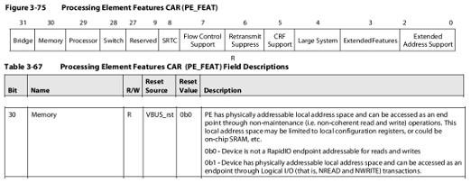

Actually, the above code is equal to : *((unsigned int *)0x0290b010) = 0x20000199.
This means writing 0x20000199 to Processing Element Features CAR (PE_FEAT) register.
The following figure is extracted from KeyStone Architecture Serial Rapid IO (SRIO) User Guide (SPRUGW1B).
I think C6678 is a PE which has physically addressable local address space and can be accessed as an end point through non-maintenance (i.e. non-coherent read and write) operations. So the bit 30 in PE_FEAT should be set 1. But the code writes 0x20000199 to the register( this means bit 30 is set to 0) and the phenomenon is the example code runs  successfully. It really confuses me. The  following figure is extracted from SPRUGW1B, which describes the CAR registers briefly.
My question is :
Whether the PE_FEAT register is used to configure the function of the local SRIO or it is just used to be read by a remote SRIO to determine the local SRIO’s capability ?
Whether the PE_FEAT register has affect on the function of the local SRIO or not ? If it has, please explain why the bit 30 of PE_FEAT register is set to 0 .

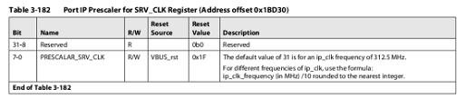

4.  /* Set the LLM Port IP Prescalar. */
    CSL_SRIO_SetLLMPortIPPrescalar (hSrio, 0x21);
This means writing 0x21 to Port IP Prescalar for SRV_CLK Register
But the RefClk on my C6678 EVM is 312.5MHz, so I think the value 0x21 should be modified to 0x1f, am I right?

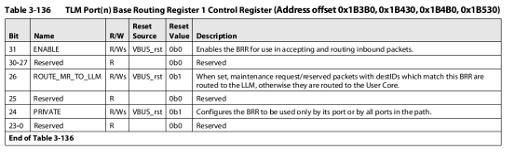

What does the LLM mean  in the figure?
    None of the CAR (capability registers) affect function.  They provide info to other devices when read.  The DSP is a processor as the PE_FEAT describes, the memory bit would indicate a memory only device with an SRIO interface.  The RapidIO spec allows for such a device.
    The srv_clk is the internal bus frequency, which is CPU/3.  The settings for the prescalar are not strict and overlap somewhat, so adjust to your preference.
    It is the hardware module that responds automatically to an incoming maintenance packet.  This may be bypassed if the DSP is put in a promiscuous mode.  However, you don't need to worry about this bit to control the destID checking, the better way is to use the 3 control bits that are shown in table 2-22.  These three bits control how incoming maintenance and regular packets are handled.
