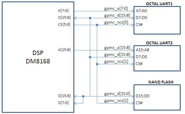

With GPMC i want to configure Two 8 bit OCTAL UART and 16 Bit Nand Flash shown in figure below
Can i use the GPMC configuration as shown above.
Thank u very much in advance
Sanjeev
