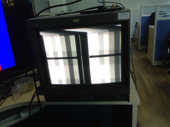

    What error are you seeing? Is the output image correct? which decoder connected to vout0 detecting bt656 output?
    Brijesh
  • We are using SAA7121 connected to DM8167's VOUT0;
    The register settings of SAA7121 are copied  from our DM6467T->BT.656/625i->SAA7121 Custom Board, which display OK;
    Picture:
  • I learned a macro VPSHAL_HDVENC_ADJUST_TIMING_FOR_SHIFT_ISSUE in vpshal_hdvenc.c, it applied to FVID2_SF_PROGRESSIVE now, should it apply to FVID2_SF_INTERLACED too?
  • No This flag is not required for interlaced mode. Let me check the settings again.
    Brijesh

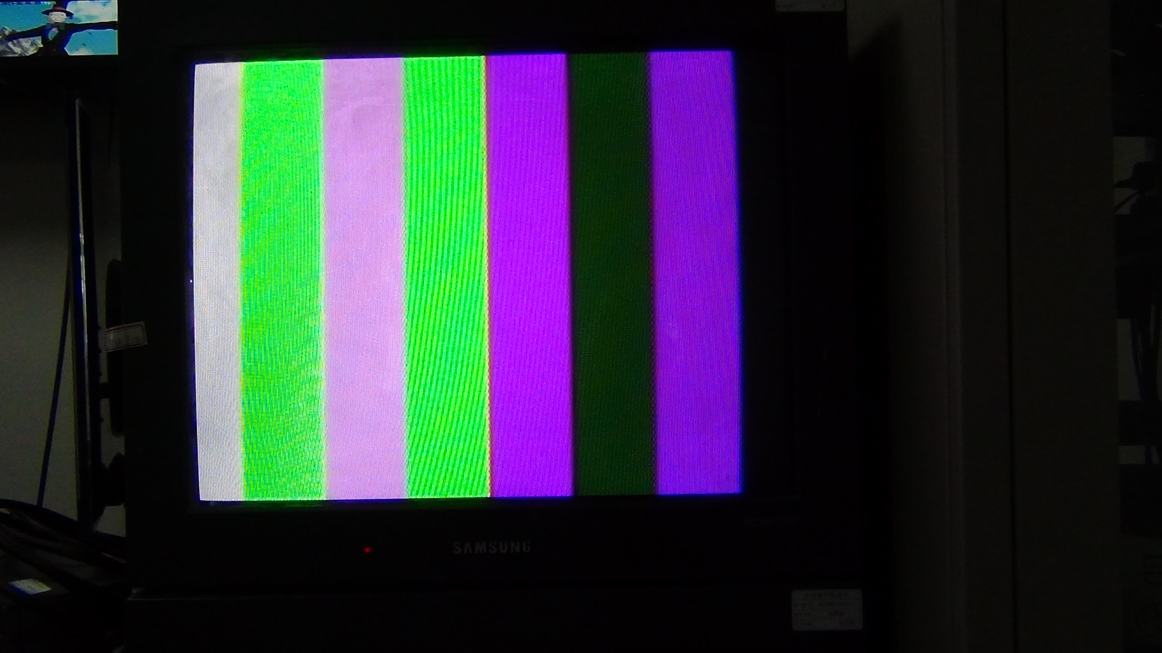

  • Hi Brijesh:
    I using another register configures and let VOUT0 in self test mode(color bar), then get following screen shot
    It seems incorrect color bar color, which register is wrong?
    REG diffs:

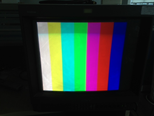

  • Thanks Chris Meng (孟海燕) ,Under she's help, We solved this problem;
    With following Register settings:
    [CortexM3_ISS_0] CFG00(0x4810a000): 0x4420305c
    [CortexM3_ISS_0] CFG01(0x4810a004): 0x003f0275
    [CortexM3_ISS_0] CFG02(0x4810a008): 0x1ea500bb
    [CortexM3_ISS_0] CFG03(0x4810a00c): 0x1f9901c2
    [CortexM3_ISS_0] CFG04(0x4810a010): 0x1fd71e67
    [CortexM3_ISS_0] CFG05(0x4810a014): 0x004001c2
    [CortexM3_ISS_0] CFG06(0x4810a018): 0x00200200
    [CortexM3_ISS_0] CFG07(0x4810a01c): 0x184c0c77
    [CortexM3_ISS_0] CFG08(0x4810a020): 0x1c0c0c30
    [CortexM3_ISS_0] CFG09(0x4810a024): 0x1c0c0c30
    [CortexM3_ISS_0] CFG10(0x4810a028): 0x84271360
    [CortexM3_ISS_0] CFG11(0x4810a02c): 0x3f150017
    [CortexM3_ISS_0] CFG12(0x4810a030): 0x3f2d8081
    [CortexM3_ISS_0] CFG13(0x4810a034): 0x00000137
    [CortexM3_ISS_0] CFG14(0x4810a038): 0x00038338
    [CortexM3_ISS_0] CFG15(0x4810a03c): 0x3f2d0090
    [CortexM3_ISS_0] CFG16(0x4810a040): 0x00018000
    [CortexM3_ISS_0] CFG17(0x4810a044): 0x00120150
    [CortexM3_ISS_0] CFG18(0x4810a048): 0x03002120
    [CortexM3_ISS_0] CFG19(0x4810a04c): 0x03001142
    [CortexM3_ISS_0] CFG20(0x4810a050): 0x0013e13a
    [CortexM3_ISS_0] CFG21(0x4810a054): 0x3f2d0088
    [CortexM3_ISS_0] CFG22(0x4810a058): 0x00018001
    [CortexM3_ISS_0] CFG23(0x4810a05c): 0x00120150
    [CortexM3_ISS_0] CFG24(0x4810a060): 0x03001120
    [CortexM3_ISS_0] CFG25(0x4810a064): 0x0300412b
    [CortexM3_ISS_0] CFG53(0x4810a0d4): 0x00000000
    [CortexM3_ISS_0] CLKC VidEnc ClkSel: 0x0008010d
    Some Registers Still has problem, We will continue debug them;

    2013-8-2
  • good to see it started working..
    I believe the only change required is clk2x should be set to 27MHz and clk1x to be 13.5Mhz. Correct?
    Brijesh
  • Hi Brijesh:
     Yes, That's the key!
    enigma
