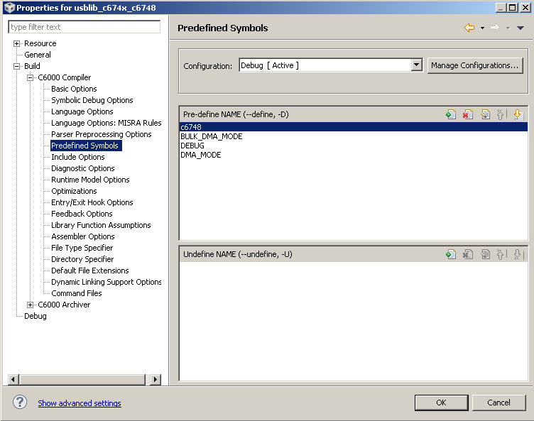

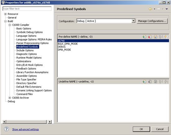

    I have enabled CPPI DMA for TX and RX transfers in usb bulk driver & usb_dev_bulk example(attached the modified files).
    I am able to receive the data successfully with DMA from host but while transmitting back to host I am facing some issues(Debugging the same).
    Build Procedure:
    1. While building the usblib (usblib_c674x_c6748), enable the BULK_DMA_MODE & DMA_MODE compiler predefined symbols.
    2. While building the usb bulk example (usb_dev_bulk_c674x_c6748_lcdkC6748), enable the BULK_DMA_MODE compiler predefined symbol.

  • Hi Holger,
    I have fixed the USB packet transmit issue reported earlier and attached the updated source.
    Enable BULK_DMA_MODE compiler predefined symbol in usblib & usb_dev_bulk, no change in the build procedure.

  • Hi
    I used the files you attached
    defined BULK_DMA_MODE
    defined DMA_MODE
    set the USB_POWER_HS_MODE flag
    still only getting 1mbps
    Processor running at 300mhz
    Not much else happening in the system, I can increase the number of data blocks if I reduce the size per block, so it points to a raw throughput issue.
  • It appears the function USBBufferWrite hogs the processor until the data transfer is complete.
    I was expecting this call to be fast after switching to DMA mode.
