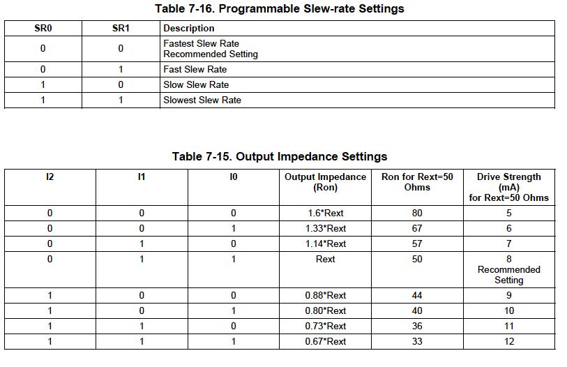

I have questions regarding slew rate and impedance setting of AM3874.
Please see the following.
Table 7-15 shows that the Drive Strength is the control of driver current. And it can be done by  changing to the internal resistance of AM3874.
Tabcle 7-16 shows that Slew rate can be changed by resister setting.
1) As I wrote the above, the driver current can control by changing to the internal resistance of AM3874. How about Slew rate? What factor is controlled?
2) If SR0/SR1 setting is changed, how is waveform changed?
3) How does the waveform affect by changing the drive current?
Please advise me.
I appreciate your quick reply.
