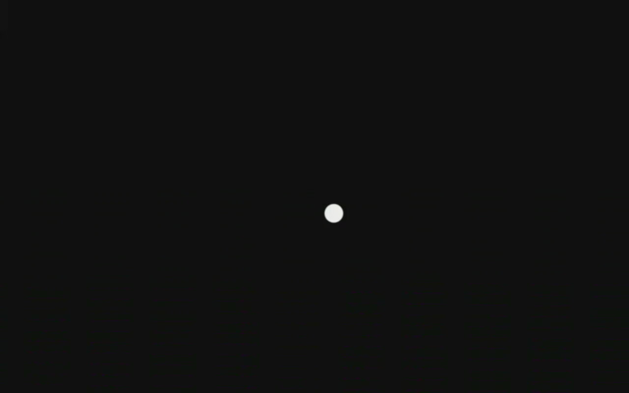

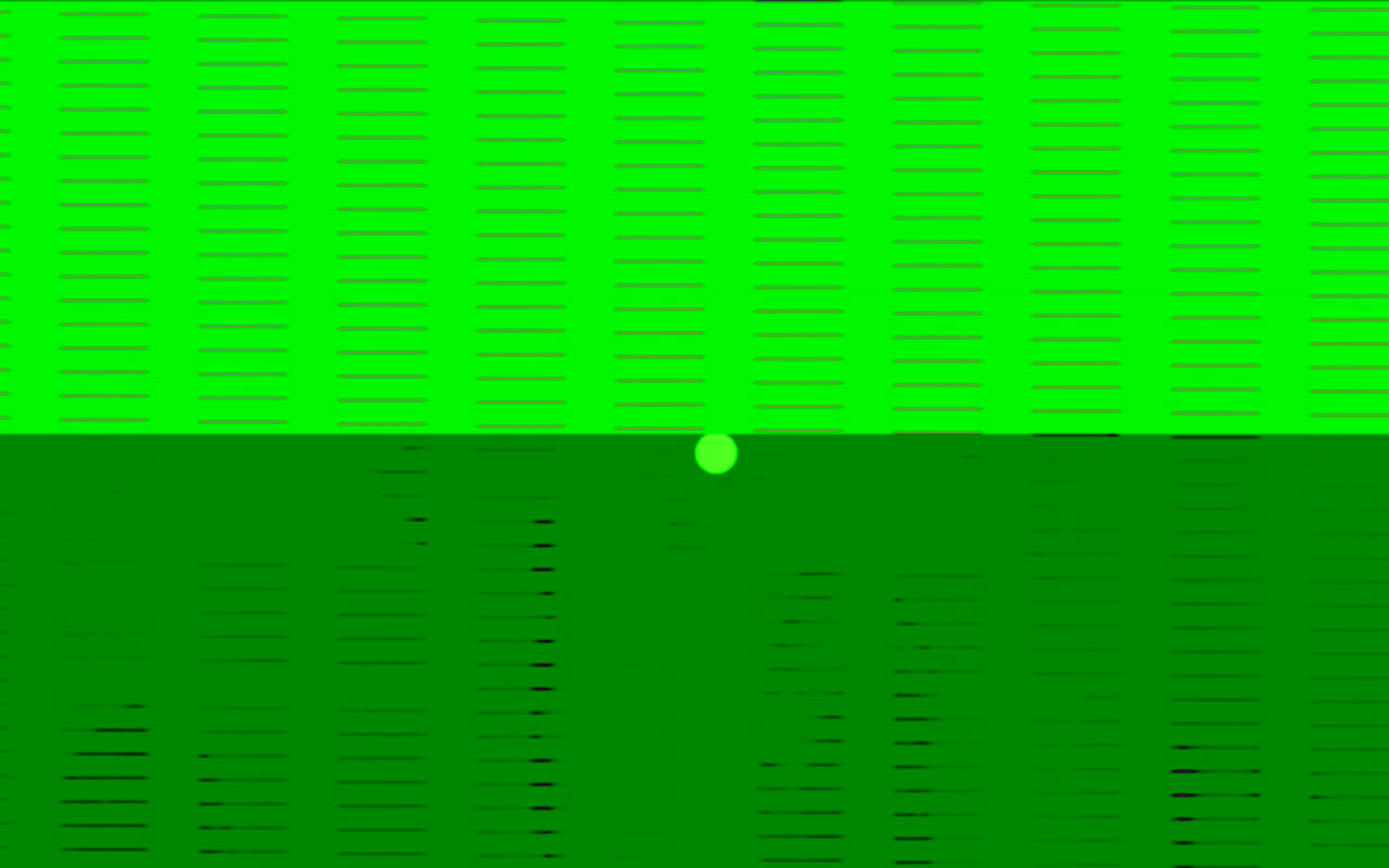

OMX.TI.VPSSM3.VFPC.NF issue with EZSDK decode_display example

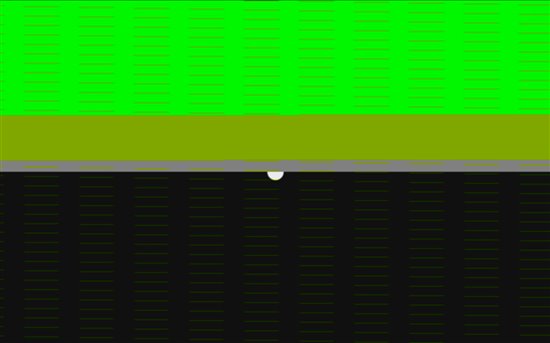

HI !
I am using a noise filter to perform YUY2->NV12 conversion with EZSDK 5_05_02.
When using this component, I always get a few jerky frames (2 or 3) on the output of the noise filter. I noticed that this issue also appears with the decode_display example found in component-sources/omx_05_02_00_48/examples/ti/omx/demos/decode_display/ (I get a frame full of grey pixels)
Is this a known bug in your driver or an issue in the configuration? This is rather a blocking issue to me since the output of my application always has those two dirty frames...

  • Hi Margarita !
    Thank you for your reply. I had a look at the other topic and I think it is a different issue indeed.
    Just to make sure you understand what I'm trying to solve, here is a GStreamer pipeline that shows the 'bug'.
    $ GST_DEBUG=*:3 gst-launch -vvvve videotestsrc pattern=18 ! 'video/x-raw-yuv, format=(fourcc)YUY2, width=1280, height=720, framerate=(fraction)30/1' ! omx_noisefilter ! omx_h264enc ! 'video/x-h264, width=1280, height=720, framerate=(fraction)30/1' ! h264parse output-format=0 ! mp4mux ! filesink location=./out_2.mp4
    Any ideas why I get this?

    Are you using EVM or it is custom board?
    Margarita
  • Hello !
    I'm using a Z3-DM8168-RPS board.
    Pierre-Louis.
    Could you try:
    encode:
    gst-launch videotestsrc pattern=18 ! 'video/x-raw-yuv,format=(fourcc)YUY2,width=1280,height=720,framerate=(fraction)30/1' !  omx_noisefilter  ! queue  ! omx_h264enc   bitrate=10000000 ! gstperf ! filesink location=sample.264 -v
    decode:
    gst-launch -v filesrc location=sample.264 ! typefind ! h264parse ! omx_h264dec ! omx_scaler ! omx_ctrl display-mode=OMX_DC_MODE_1080P_60 ! gstperf ! v4l2sink device="/dev/video1" show-preroll-frame=false sync=false min-queued-bufs=2
    Let me know the result.
    Margarita

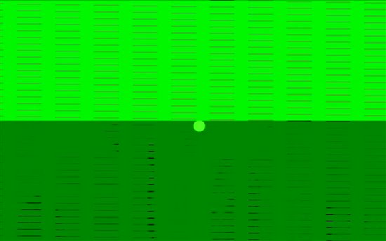

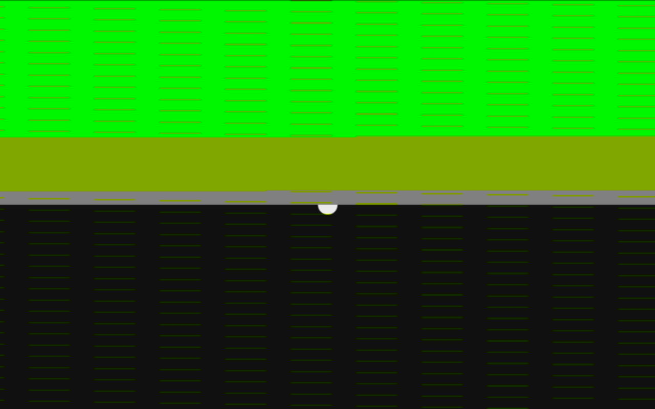

    => Typefind does not find the proper framerate hence the message "_gst_util_uint64_scale_int: assertion `denom > 0' failed". This is fixed by using the following pipeline :
    $ gst-launch -v filesrc location=sample.264 ! 'video/x-h264,width=1280,height=720,framerate=(fraction)30/1' ! h264parse ! omx_h264dec ! omx_scaler ! omx_ctrl display-mode=OMX_DC_MODE_1080P_60 ! gstperf ! v4l2sink device="/dev/video1" show-preroll-frame=false sync=false min-queued-bufs=2
    In both cases, I still get jerky frames (grey and green) when playback starts.
    Pierre-Louis.
    It is normal  to see last lines green. If you change height=720 in the encoding pipeline to be multiple of 32 you will not see it. For example set it to 800.
    encode:
    gst-launch videotestsrc pattern=18 ! 'video/x-raw-yuv,format=(fourcc)YUY2,width=1280,height=800,framerate=(fraction)30/1' ! omx_noisefilter ! omx_h264enc force-idr-period=300 i-period=100 bitrate=12000000 !  gstperf  ! filesink location=test.264
    decode:
    gst-launch filesrc location=test.264 ! 'video/x-h264' ! h264parse access-unit=true ! omx_h264dec ! omx_scaler ! omx_ctrl display-mode=OMX_DC_MODE_1080P_60 ! gstperf ! omx_videosink sync=true
    When you are using omx_noisefilter: Width/pitch/height should be multiple of 32 pixels.
    Margarita

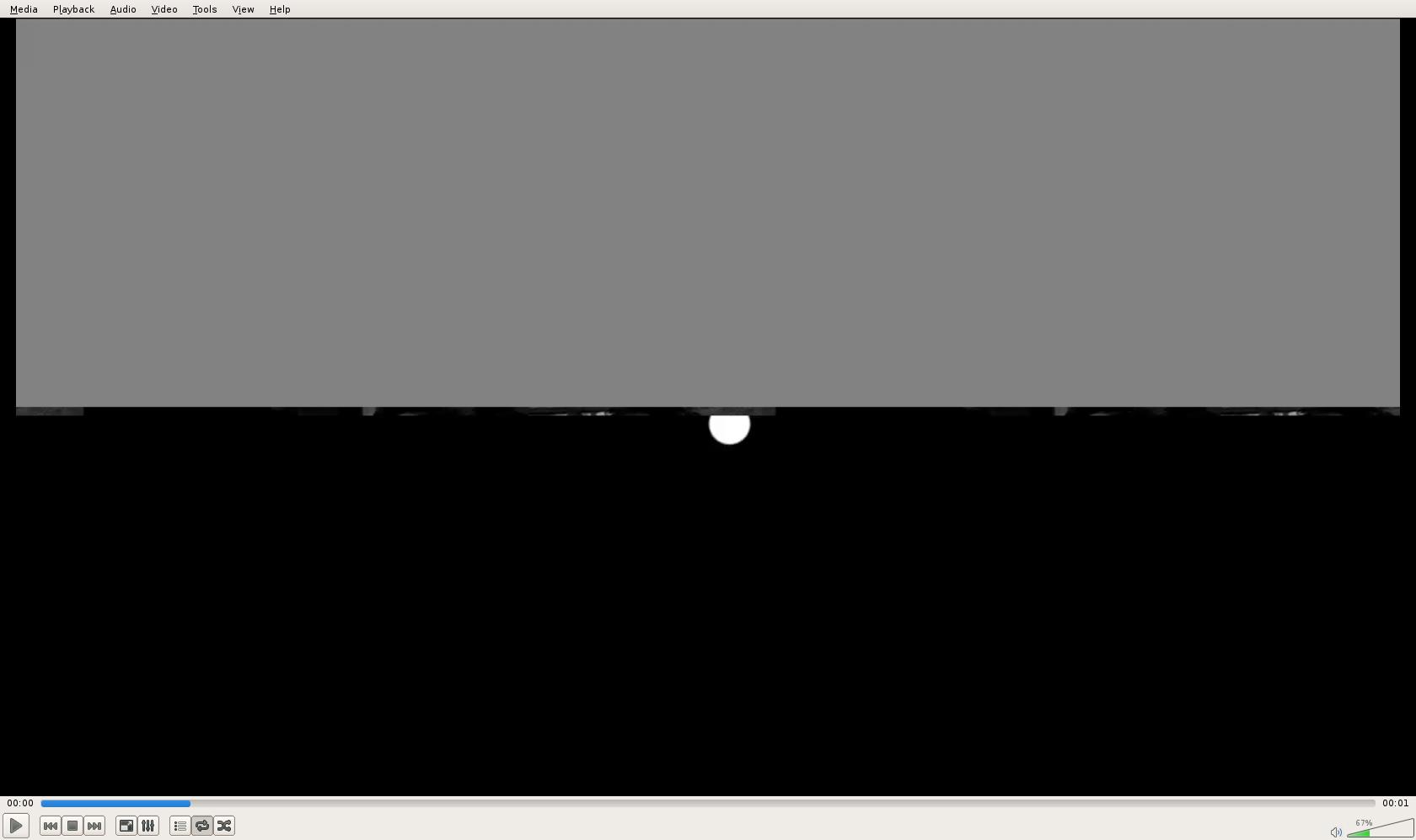

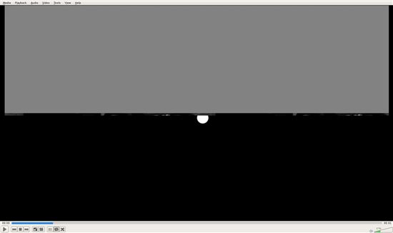

  • Hello!
    I knew about grey lines at the bottom of the frames and the limitation with omx_noisefilter sizes.
    So, this is what I do to show you the issue:
    • Encoding:
    gst-launch videotestsrc pattern=18 ! 'video/x-raw-yuv,format=(fourcc)YUY2,width=1280,height=800,framerate=(fraction)30/1' ! omx_noisefilter ! omx_h264enc force-idr-period=300 i-period=100 bitrate=12000000 !  gstperf  ! filesink location=test_800.264
    • Decoding:
    $ gst-launch -v filesrc location=test_800.264 ! typefind ! h264parse ! omx_h264dec ! omx_scaler ! omx_ctrl display-mode=OMX_DC_MODE_1080P_60 ! gstperf ! v4l2sink device="/dev/video1" show-preroll-frame=false sync=false min-queued-bufs=2
    I did extract all the frames with the following pipeline:
    $ gst-launch -vvve filesrc location=test_800.264 ! 'video/x-h264' ! h264parse access-unit=true ! omx_h264dec ! omx_scaler ! jpegenc ! multifilesink location=./output_%05d.jpg
    And this is what I get for the first three frames :
    1/
    2/
    3/ Frame is correct:
    There is clearly something with a wrong initialization or reset procedure. What do you think?
    Here is a pipeline that shows the issue of omx_noisefilter :
    $ GST_DEBUG=*:3 gst-launch videotestsrc pattern=18 ! 'video/x-raw-yuv,format=(fourcc)YUY2,width=1280,height=800,framerate=(fraction)30/1' ! tee name=before ! queue ! jpegenc ! multifilesink location=before_nf_%05d.jpg before. ! queue ! omx_noisefilter ! 'video/x-raw-yuv,format=(fourcc)NV12,width=1280,height=800,framerate=(fraction)30/1' ! swcsc ! 'video/x-raw-yuv,format=(fourcc)I420,width=1280,height=800,framerate=(fraction)30/1' ! jpegenc ! multifilesink location=./after_nf_%05d.jpg -vvve
    You'll see that the input is correct while the output has two dirty frames. Hope this helps.
    Pierre-Louis.
