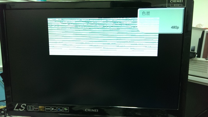

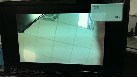

Hi there,
The frame buffer is 640x480.
Current FW can output it in component 480i as below.
However, if I toggle VMOD.HDMD to 1 in CCS, it becomes
Please indicate the right register settings.
Thanks & regards,
Yulin.
  • Have you changed VMOD.TVTYP to 525P, and proper timing parameters (Table 3 of sprufg9c)?

  • Hi Ivan,
    The HW defect is no DAC driver populated.
    The PCBA I am using has lots (and weak) manual wires to the DAC driver on another model PCBA.
    With this fix, 480i component output is OK but 525p is NG.
    VMOD.TVTYP=0 is common to 480i and 525p.
    Table 3 of sprufg9c suggests ETMG3.MLBI=243 for 525p but ETMG3.MLBI is a field of only 4bits.
    BR,
    Yulin.

  • Can you check if the external DAC you plan on using supports 720P30?  And if so, what are the timing requirements?
  • Hi Ivan,
    It's a TI THS7303 line driver (not ext. DAC) configured in 525p mode.
    I am targeting at 525p, not 720p30.
    BR,
    Yulin.
  • Hi Ivan,
    Is 74.25MHz required to drive 525p component output ?
    How can DM356 support 525p component output ?
    Yulin.
  • Yulin,
    I believe this needs only 54MHz.
  • Yulin,
    After double checking with our video expert, it seems that 27MHz at 16-bit should suffice (54MHz needed for 8-bits only).
