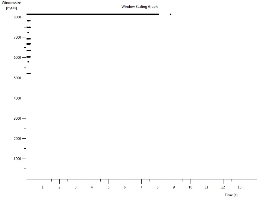

  • Can you verify the window size the NDK is using with Wireshark? It seems that it is still using a smaller window like 8kB, which would require more interrupts.

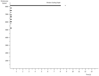

  • I checked the  windows size, and I think it is indeed 8kB I guess, see the figure below:
    Is it possible to change this size to a more suitable value?
    Thanks!
  • If you are using the legacy API to configure the NDK, you can set the RX and TX buffers like this:
        int rc = 64000;
        // TCP Transmit buffer size
        CfgAddEntry( hCfg, CFGTAG_IP, CFGITEM_IP_SOCKTCPTXBUF,
                     CFG_ADDMODE_UNIQUE, sizeof(uint), (UINT8 *)&rc, 0 );
        // TCP Receive buffer size (copy mode)
        CfgAddEntry( hCfg, CFGTAG_IP, CFGITEM_IP_SOCKTCPRXBUF,
    If you are using RTSC instead, it should work like this:
    var Tcp = xdc.useModule('ti.ndk.config.Tcp');
    Tcp.transmitBufSize = 64000;
    Tcp.receiveBufSize = 64000;
    Ralf
  • Thats it, now i'm getting more than 900Mb/s.
    First I tried your suggestion of 64000 and got 620Mb/s of speed, then I increased the size of the buffer till i got to more than 900Mb/s, now the buffer size is 150000 and I think I got maximum speed.
    Thanks for the help!!
