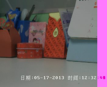

My resolution is 352X288. When I open the vnf,there is a problem with the picture,as shown below.I don't know why.
I am stuck here completely for sometime so any help would be greatly appreciated.
XiaoLi

Hi XiaoLi,
Pl. note that VNF will output invalid 32 pixels on right and 32 lines at the bottom.
So if you input (352+32)x(288+32) then you will get 352x288 output.
What in VNF input resolution?
regards,
Anand
Hi Anand,
The vnf input resolution is right! There was no problem with VGA ,720p and 960p when I opened VNF. I don't know what hanppened to CIF.

Hi XiaoLi,
I tested VNF for 352x288 resolution and it is working fine on my side.
I guess you may be using an old version of the VNF lib.
Can you tell me the version of VNF lib you are using?
You can get in touch with your local TI FAE for the latest version of VNF.
regards,
Anand
Hi Anand,
My version of VNF lib is KTNF.version.1.0.wizardversion.0.5.3. What's your version? Is mine same with yours?
