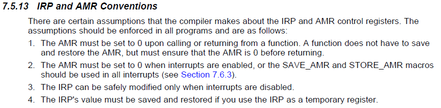

  • Robert W said:
    I remember that someone did not suggest me using circular addressing in FIR implementation in the past on TI's forum for BIOS (and DSP status register) reason.
    A bit off topic. The attitude toward assembly programming is generally "hostile" [i.e. as maintained by participating TI employees], not to mention usage of esoteric capabilities such as circular addressing. I'd argue that it's rather rude to discourage people from using it, but it's rude not toward discouraged programmers, but toward TI hardware designers. Indeed, compare the effort devoted into providing really cool capabilities, and effort to advise not to use them.
    As for specifically circular addressing. As already implied earlier [in that other thread], the question whether or not to use it is effectively equivalent to whether or not operating environment supports it and if not, whether or not you are in position to do something about it. Or in even more practical terms. If you have source code for all interrupt service routines, then you can add pair of lines to each one of them to allow AMR usage [in interruptible code]. Ideally it should be arranged by compiler, i.e. handling of AMR (as well as some other status registers) in subroutines declared as interrupt handlers. But this would require an attitude change from TI...
  • Please see section 5.1.3 of the Compiler User Guide:
    Also, please look for the intrinsic version of any special assembly instruction you may want to use. The compiler team tries to have an intrinsic available for any instruction that would not normally be used by the compiler, such as GMPY or LMBD. These are listed in the Compiler User Guide.
