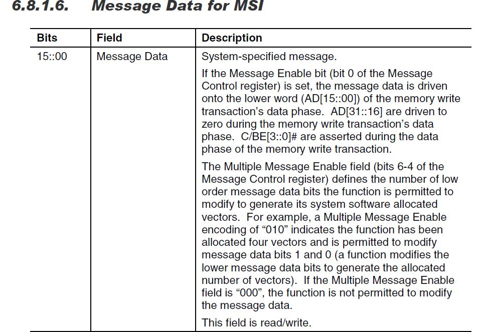

    and for question one, why should i write 0x100 to trigger vector 8?
     as
    "You can set 1 to bits of MSI_IRQ to trigger MSI interrupt with different vectors, such as write 0x0 to trigger MSI vector0 and write 0x100 to trigger vector 8."
    why write 0 to trigger vector 0? not write 1 ? the MSI_IRQ has 32bits ,each one represent a vector?
    It is a message data description in the PCI specification, which is referenced in the PCIe specification, I'm a little confused, I will try different config, but i am welcome for your
    suggestions.
    it is in page 243 of this pdf:
    1016.PCI.Local.Bus.Specification.Revision.3.0.pdf

    I've found out the right way to trigger 0,8,16,24 vectors.
    we should write 0,8,16,24 directly to MSI_IRQ, and each vector will assert the 0 ,1,2,3 bit in MSI0_IRQ_STATUS, also , i have to enable the four vector in MSI0_IRQ_ENABLE_SET(0x0000000F).
    Problems solved ,Thank you ,Steven Ji
    really appreciate!!!!!
  • Xing,
    Sorry for the previous confusion. And you are right that, for the MSI_IRQ register, we should write "VALUE" into this register to trigger the MSI interrupt. Not  each bit represents each MSI interrupt, but the data value written into the register represents the number of MSI interrupt.
    So just like the description in the UG, in order to trigger MSI 0, we should write 0x00000000 to this register, instead of 0x00000001. Similarly, to
    trigger MSI 31, we should write 0x0000001F to this  register, instead of 0x80000000.
