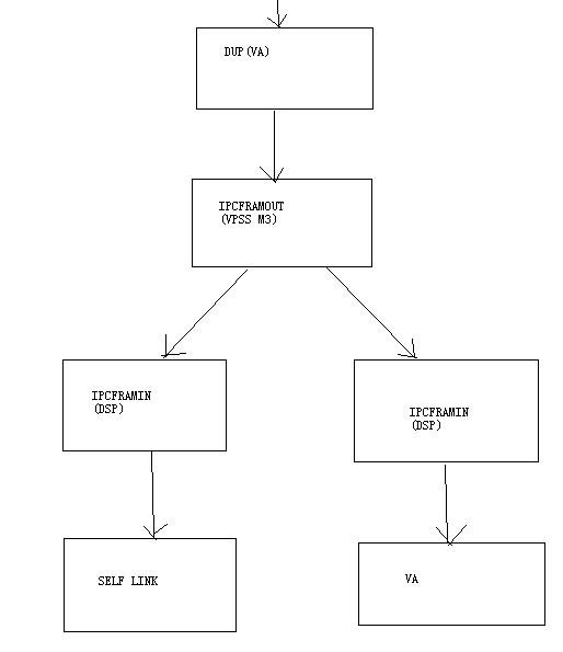

when newly created link add into IPNC RDK demo links chain,assert failure.
hi, TI expert:
when newly created link is added to IPNC RDK demo links chain,assert failure occurs by follow asserts.
1、UTILS_assert(pObj->createArgs.inQueParams.prevLinkQueId < pObj->inTskInfo.numQue);
2、UTILS_assert(pObj->inQueInfo.numCh == 1);
log is follow:
[c6xdsp ]  11677: Assertion @ Line: 70 in links_common/va/vaLink_tsk.c: pObj->inQueInfo.numCh == 1 : failed !!!
how to avoid this asssert failure?
thanks
  • with Supplement:
    ipcFramesOutVpssPrm.baseCreateParams.numOutQue = 2;
      ipcFramesOutVpssPrm.baseCreateParams.outQueParams[0].nextLink = ipcFramesInDspId[MY_FRMINDSP_IDX];
      ipcFramesOutVpssPrm.baseCreateParams.outQueParams[1].nextLink = ipcFramesInDspId[VA_FRMINDSP_IDX];
      ipcFramesOutVpssPrm.baseCreateParams.notifyNextLink = TRUE;

  • Hi Simon,
    VA link expects only one channel in its input queue.
    In your usecase there are more than one channels in the VA link input queue.
    How many channels are present in each of the output queues of VPSS ipcFramesOut link?
    regards,
    Anand
  • many thanks for the response firstly.
    In my usecase code config of  ipcFramesOut link:

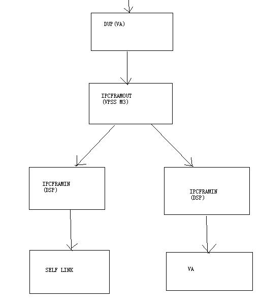

  • Hi,Anand
    I use the Appro IPNC RDK 3.5 usecase of multich_tristream_fullfeature.c.
    Dual stream(H264 and mJpeg) and SMART ANALYSIS are selected on pc Web GUI .
    As above-mentioned code and diagram,I just  add my newly created alglink which act as the valink running on the DSP into the original links chain .
    without any change to the original links chain such as Scaler,Isp,camera and so on.
    in the jpg diagram ,i can normaly run  them(SELF link and VA link)seprately.but if i create and link them together,the assert failure occurs.
    many thanks.
  • Hi Simon,
    Your ipcFramesOut link has 2 output queues,and incoming channels are split into these queues.
    There is only ONE chnannel in the input queue which goes to your link and VA link doesn't get any channels hence the assertion.
    You can resolve the issue by moving the dup link on DSP. Let ipcFrameOut on VPSS have only ONE output queue which is connected to DUP link on DSP.
    DUP link on DSP will have 2 output queues one connected to your link and the other connected to VA link. DUP link doesn't split the incoming channels instead duplicated the channels on both the output queues.
    regards,
    Anand
