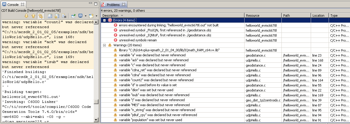

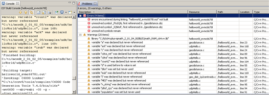

So I get this in Problems window:
Errors:
unresolved symbol _IQNtoF, first referenced in ./geodistance.obj
unresolved symbol _FtoIQN, first referenced in ./geodistance.obj
Warnings:
Description    Resource    Path    Location    Type
library "C:/ti/c64xplus-iqmath_2_01_04_00/lib/IQmath_RAM_c64x+.lib"
Someone has tried to used with c6678?  How to solve it.
Any help will be appreciated.
Julian

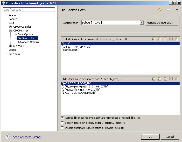

    Problems window is this:
    and the linker search path is configured as is shown  in next image:
    Thanks in advance.
    Julian
  • Julian,
    Most of the C66x software is by default built with little endian ELF format so please replace IQMATH_c64xplus_elf.lib file. The linker build error suggest mismatch of object files built in COFF and ELF format.
    Let us know if this doesn`t resolve your issue.
    Rahul
    PS: FYI, there is a bug reported in the big endian version of this library recently so if you do plan to move to big endian implementation refer to the post here:
    http://e2e.ti.com/support/dsp/c6000_multi-core_dsps/f/439/t/225956.aspx
  • Hi Julian,
    Are you still facing this issue or including the ELF version of the library has resolved the build issue.
    Rahul
  • Hi Rahul,
    changing to the elf version,  to IQmath_c64x+e_elf.lib, solved the issue.
    Thank you very much for the help.
