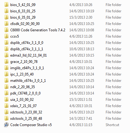

    1. What is version of  StarterWare package used by you?
    2. What are the supporting packages( with version) used to build?

    1. I am using the pdk_C6748_2_0_0_0\C6748_StarterWare_1_20_03_03\examples\lcdkC6748\vpif_lcd_loopback.
    2. Sorry, what do you mean by "supporting packages" exactly? the .h files?
