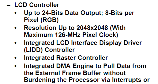

This is more of a benchmarking question.  The AM335x is capable of outputing a 2k by 2k LCD panel.
What is the maximum resolution and fps that we are able to decode an H.264 stream.  My application calls for 1366x768p30
