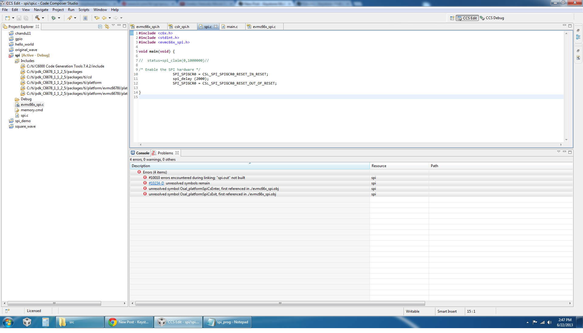

error in spi programming of tmdxevm6678 EVM
   my program for initializing SPI .

Error:
unresolved symbol Osal_platformSpiCsEnter, first referenced in    ./evmc66x_spi.obj spi C/C++       Problem
unresolved symbol Osal_platformSpiCsExit, first referenced in        ./evmc66x_spi.obj spi C/C++       Problem

  • 1. Do you still see the error please?
    I think the compiler could complain "spi_delay()" function since it is defined as "static" in "evmc66x_spi.c". You can copy it over to your "spi.c" if you see errors.
    But I do not see any problem with "Osal..." symbols you mentioned.
    2. Section 2.1 in SPI user guide mentions the equation of SPICLK. The SPI module clock seems to be SYSCLK1/6, where SYSCLK1 is the CorePac clock.
    You can program PRESCALE in SPI register to get the clock frequency you need.
