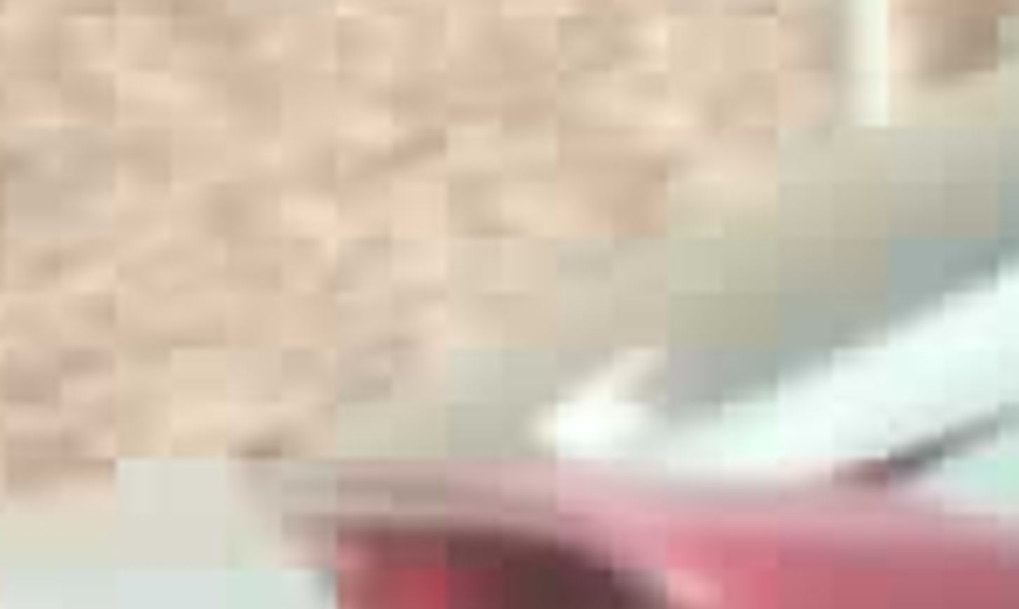

captured video looks very sharp on HDMI monitor, but very blurry on MJPEG stream.
here's the zoom in of the jpeg frame, you can see the blocks.
I tried increasing the target bitrate, all the way up to 10mbps, but each captured frame is still around 80KB. the image viewer will tell me the JPEG quality is 50.
I also played with the qpMax, qpMin, which dont see to make any difference.

  • jpeg static parameters: rateControlParamsPreset=0,scalingMatrixPreset=0rcAlgo=1,qpI=-1,qpMaxI=51,qpMinI=1,qpP=-1,qpMaxP=40,qpMinP=10,qpOffsetB=4,qpMaxB=44,qpMinB=10
    jpeg dynamic parameters: qualityFactor=50,rateControlParamsPreset=4,scalingMatrixPreset=0rcAlgo=0,qpI=0,qpMaxI=0,qpMinI=0,qpP=0,qpMaxP=0,qpMinP=0,qpOffsetB=0,qpMaxB=0,qpMinB=0
    I guess this is where the number 50 is from. The dynamic parameters were initialized using a global variable JPEGVENC_TI_DYNAMICPARAMS, I guess its default value is 50.
    I will try modifying  this value.
  • I changed qualityFactor to 90, increased targetbitrate to an insane 30mbps for 5fps 1080p MJPEG stream. The image still looks very blurry.
    Single frame size now is about 200KB. In the picture below, I can  very easily read the license plate number on HDMI monitor.

  • thanks for the reply.
    I posted the parameters in previous post, rateControlParamsPresetwas set to 4 in dynamic parameters. I tried 0, no difference though. all other parameters related to quality control were set to zero.
    Please advise which parameters need to be set nonzero, in static and dynamic parameters, to make it work properly.
  • Are you interested on rate control?
    If not , use the below parameters for disable rate control.
    QualityFactor   = 75                     # this parameter range 1-100.
    RateControlPreset = 4                # 1 => Low Delay(CBR), 2=>VBR, 4 => None

    As Naidu mentioned, you can use ratecontrol on MJPEG if you need to control bitrate of the MJPEG encoding.
    This is supported in IPNC RDK version 3.5.0, please procure this from Appro website or contact local sales
    You cna upgrade the MJPEG codec version and make changes to intreface and codec params as done in IPNC RDK
    If you are using v3.5,  you cna set the MJPEG RC mode from "Rules.Make" and check details in UserGuide and DesignGuide on how to make changes or use MJPEG RC feature
