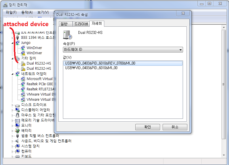

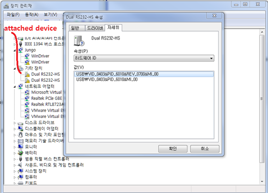

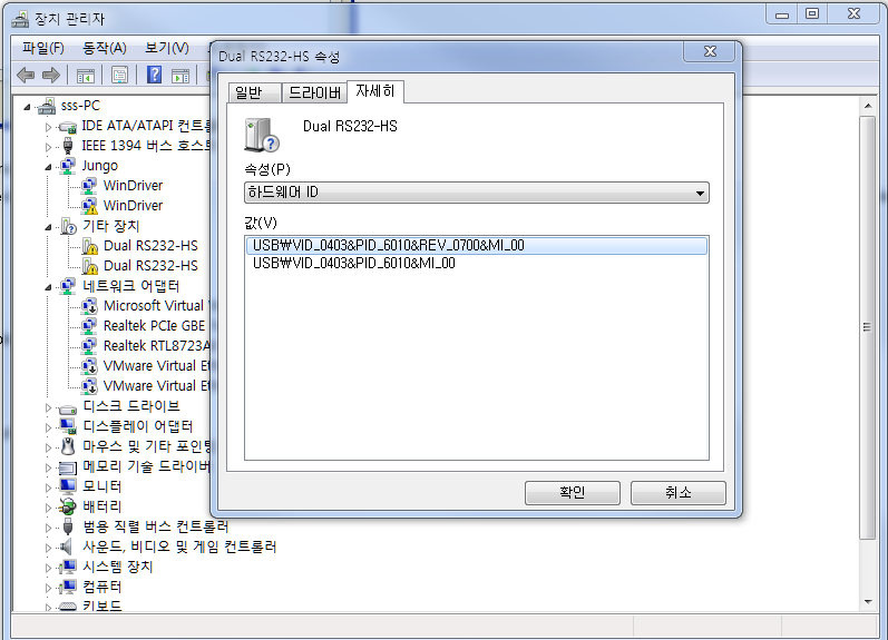

Dear All,
When I connect my eZdsp5535 to the notebook, a driver information was not correctly display.
How can I fix this problem?
OS is win_7(64bit).
Currently, only FTDI on C5535 is connected  to the computer.
Where can I get  the proper driver?
Many thanks ahead.
Andrew.
Below is the message from "Test Connection" from CCS5.3.
[Start]
Execute the command:
%ccs_base%/common/uscif/dbgjtag -f %boarddatafile% -rv -o -F inform,logfile=yes -S pathlength -S integrity
[Result]
-----[Print the board config pathname(s)]------------------------------------
C:\Users\andrew\AppData\Local\.TI\4084209646\     0\0\BrdDat\testBoard.dat
-----[Print the reset-command software log-file]-----------------------------
This utility has selected a 100- or 510-class product. This utility will load the adapter 'jioserdesusb.dll'.
An error occurred while soft opening the controller.
-----[An error has occurred and this utility has aborted]--------------------
This error is generated by TI's USCIF driver or utilities.
The value is '-151' (0xffffff69). The title is 'SC_ERR_FTDI_OPEN'.
The explanation is: One of the FTDI driver functions used during the connect returned bad status or an error. The cause may one or more of: invalid emulator serial number, blank emulator EEPROM, missing FTDI drivers, faulty USB cable. Use the xds100serial command-line utility in the 'common/uscif' folder to verify the emulator can be located.
[End]
