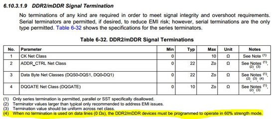

  • We think we have identified the issue.
    We did not use any termination for DDR2 interface on the board but we missed the comment regarding the drive strength. Reading through the datasheet in Table 6-32 it mentions that if no terminations are used then it must be programmed in 60% strength mode.
    To set the strength mode it its described in the DDR2 memory controller UG (http://www.ti.com/lit/ug/sprufi2/sprufi2.pdf)
    Table 24: SDCR (SDRAM Config Reg): Bit 18 (DDRDRIVE0)
    Since this was an issue we saw on various boards and was difficult to repeat we knew it must be an edge case. It makes sense that this could be the root cause. By changing this parameter we think we've solved the problem. Still testing but fingers crossed.
