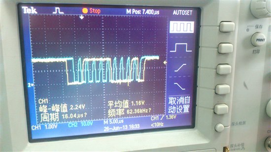

i use the digital oscilloscope only display 5640 slave address,but cannot display my regs(300a) signs.
this my oscilloscope signs:

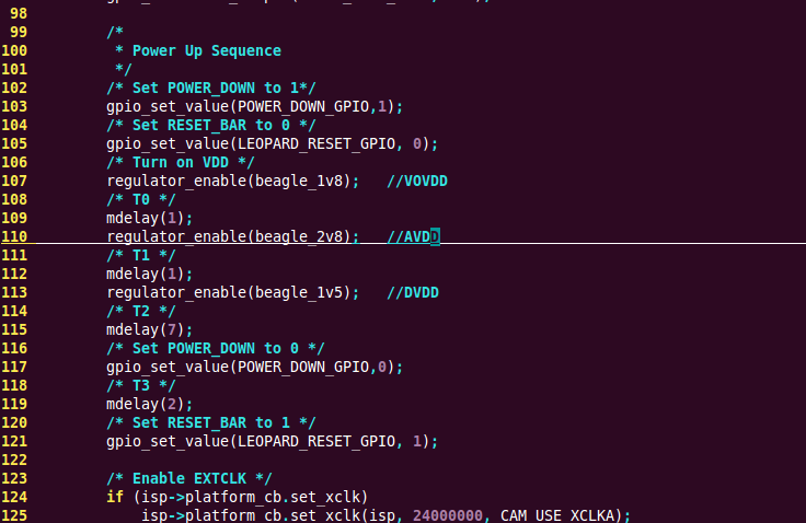

this is my power sequence and power code:

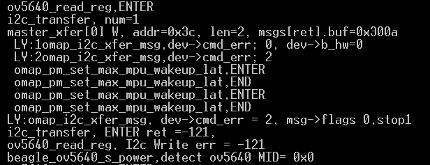

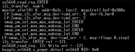

and this is minicom ouput:
