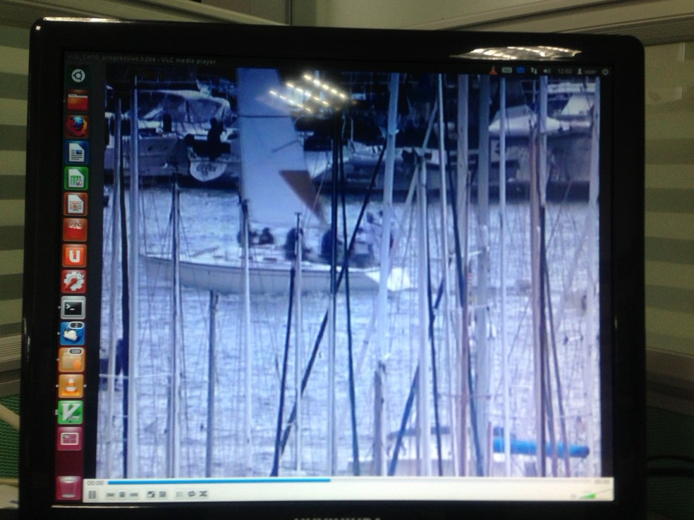

DVR RDK4.0 Interlaced encoding fieldPicture = 1 decoder report error
Other Parts Discussed in Thread: TVP5158
We are trying to implement interlaced encoding and decoding feature based on DVR RDK 4.0.
We use a YUV file as the input. The link is as below:
IpcFramesOutHost
IpcFramesInVideo
Enc
IpcBitsOutVideo
IpcBitsInHost        --->> Save encoded bits file to Host here
IpcBitsOutHost
IpcBitsInVideo
Dec
IpcOutVideo
IpcInVpss
SwMs
Display
When I use progressive encoding and decoding, both the encoded file and display on HDMI are good. I use a 704*576 YUV file.
Please see encoded picture below:
Please see display picture below:
  • Can you confirm if the encoded frame quality is not good or the display frame quality is not good. RDK 4.0 does not support deinterlacing in SwMs so SwMs will display only top field and quality will not be good. Encode quality should be good. Support for SwMs to Deinterlace and display will be supported in next RDK release
  • but when I read the same YUV file in interlalced mode and set encoding, decoding to interlaced mode. If I set fieldPicture = 0, the encoding, decoding, display is good. Please see good log below:
