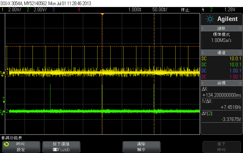

We use Sony ITN2 with IMX136 sensor base on DM368, and have a problem about the video output from DM368.
The IMX136 send YUV data at7.5fps to ITN2, and the Sony ITN2 send a YUV4:2:2 at 30fps,1080P data to DM368.

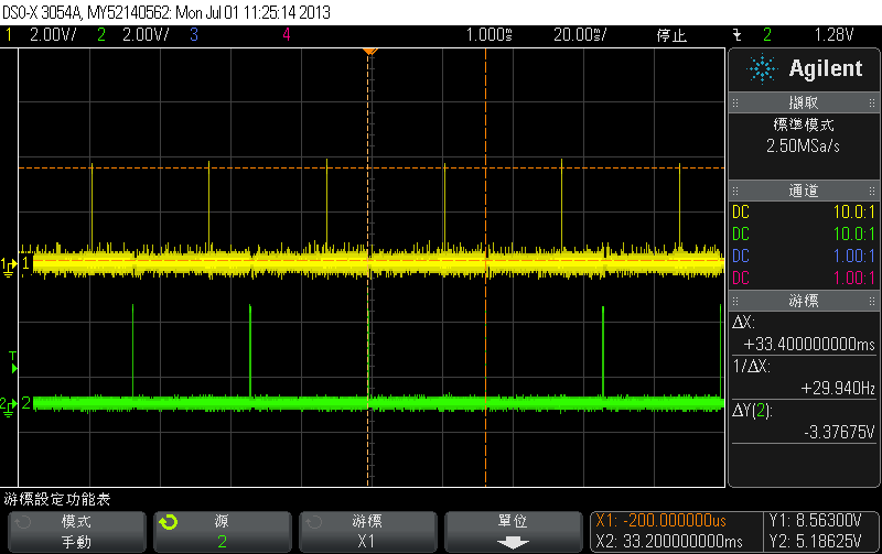

Green is VD.
Yellow is test pulse for DM368 check VD interrupt timing.
We found test pin is not sync with VD signal even in 30fps mode.
7.5fps
30fps
