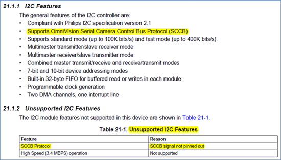

Does AM335x support SCCB?
I'm confused about SCCB?
Supports ???
Unsupported???
