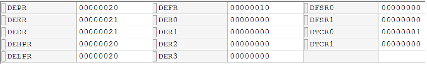

  • Sivaraj K,
    Your recommendation is so useful,I appreciate you so much.Below is the control regesters image:
    I consider that the DEER is right,the DEFR should be 0x00000020,and the DER0 should be 0x00000020,but they not.I check the configuration of my regesters,but can't find what's wrong,can I bother you having a look?

  • Hi David,
    I can understand the current situation from the above control registers image which you has shared.
    Inorder to enable an event, the corresponding bit must be set in dMAX Event Enable Register (DEER). Any of the event bits in the DEER can be set to 1 to enable that corresponding event and you can try enabling events by writing 1 to corresponding bits in DEER. By doing this, you shall observe the updated status of the control registers image.
    I have looked at the code shared above, please check the status of dmaxEvent.eventUid which is the newly created event for MCASP0RX_UID after you enable an corresponding event in DEER. All the rest in the cdoe seems to be fine.
    Once an event has been posted in the dMAX Event Flag Register (DEFR), and the event is enabled in the DEER, the event flag is automatically cleared by dMAX, immediately after it starts processing the request.

  • Hi David,
    As per control registers image you shared in the previous post,
    DEER seems to be right, DEFR should be 0x00000020,and the DER0 should be 0x00000020. But now, you were trying to assign value to the address of the DEER.

  • Hi David,
    if you set the appropriate event bits in DEER and DEFR, it will be automatically reflected in DER0 since it is a read-only register. Once you set correctly, please evaluate the expected status in the dMAX control registers image and share it across the updated image.
    If the above things are taken care appropriately, you should not find any fault in your program hopefully.

  • Sivaraj K,
      Thank you.
      I tried to modifed the bit of DEFR and DTCR0 using *(Uint 32*)0x6000001c=0x00,*(Uint32 *)0x6000001c=0x20 (0x6000001c is the address of DEFR);*(Uint32 *)0x60000080=0x00(0x60000080 is the address of DTCR0),but both of them had changed.Whether they can't be changed like this?
    So,my interrupt also can't be triggered although everywhere I can thought of had been searched.
