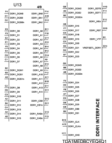

My company developed TDA1MED system based on tms320dm8148 and TI_DM814x_BB_REVD.
But, some harware configuration are different from the base.
Especially, DDR1 interface is not used and all pins for DDR1 interface is opened.
Can this  kind of hardware configuration be acceptable for normal operation ?
I am not sure about it.
If it is OK, the next issue is s/w.
U-boot memory configuration(config_ti814x_ddr() ) for dm8148 is only for using both DDR0 and DDR1 interface.
In order to use only DDR0, what configurations are supposed to be changed??

  • Hi Ji-hyun,
    For how to handle unused pins, refer to DM814x datasheet, section 4.4 Handling Unused Pins.
    Refer to the below link:
    http://processors.wiki.ti.com/index.php?title=TI814x-DDR3-Init-U-Boot#FAQ
    Q. How to enable single EMIF configurations on TI8148 u-boot ?
