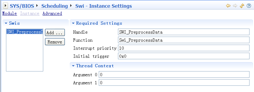

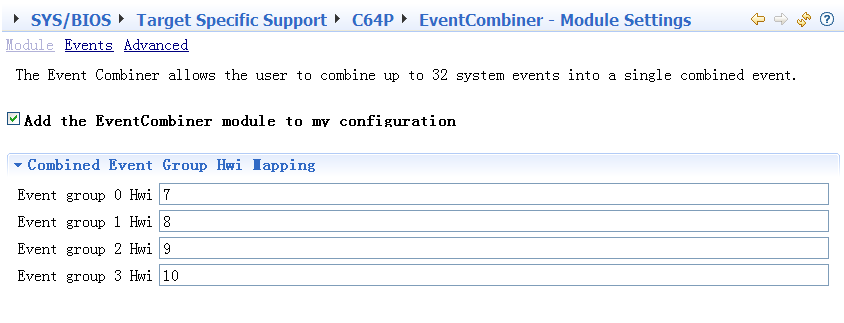

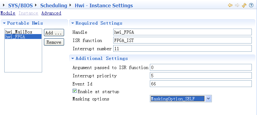

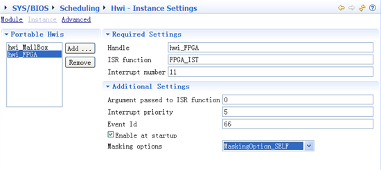

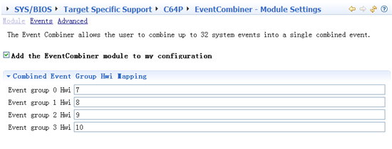

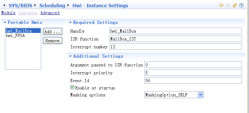

    I have a problem about edma used in Hwi and SWI code.
  When I use edma in task coed,it works fine! The callback function registered at EDMA3_DRV_requestChannel (g_hEdma, &chId, &tcc,
                                                                                                                                                                                                           (EDMA3_RM_EventQueue)0,
                                                                                                                                                                                                            &callback1, NULL);
can be triggered successfully   when data transfer completed.
But when I want to use edma in HWI and SWI code,  it is failed.The callback function didn't response when data transfer completed.
follow is my sys/bios set for HWI,SWI and Eventcombiner
HWI
SWI
Eventcombiner
