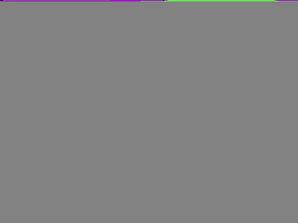

Question about the phenomenon when no signal input
Other Parts Discussed in Thread: TVP5158
Hi all
my environment is dvr03.50.00.05 with dm8168
the usecase is customed for our special product:
#define MULTI_DEI_TEST

when there is no videoinput at the three input port, the outputs of encode link is different, leading to the different phenomenon of encoded bits
If the output fps of encode link isn't 0 the encoded bits is like this(otherwise there is no bits):
the full log of Vsys_printDetailedStatistics :
2818.0710.TXT
I believe the reason comes from the capture link's output:

but I don't know why. I want to unify the three port's phenomenon when no signal input, Pls show me how to do this, Thanks
  • Any body give some support!
    If port 0 get an input video 1080p30, the capture link's output like this:
    and port 1 and port 2 doesn't output grey bits
    [m3vpss ]        |  Total     Even    Odd Total Even Odd   Min / Max Min / Max Dropped  Fid Repeat   Frame Error Y/C
    [m3vpss ] CH | Fields Fields Fields FPS   FPS FPS          Width     Height      Fields           Count   (Desc Error Y/C)
    [m3vpss ] ------------------------------------------------------------------------------------------------------------
    [m3vpss ] 000 | 19151 19151        0    30       30      0           1920 / 1920 1080 / 1080     1           0    0/0 (0/0)
    [m3vpss ] 200 | 1                   1        0       0         0      0            65535 / 0   65535 / 0            1           0    0/0 (0/0)
    [m3vpss ] 300 | 978          978        0       1        1       0            35 / 396     2 / 14                   1           0    0/0 (0/0)
