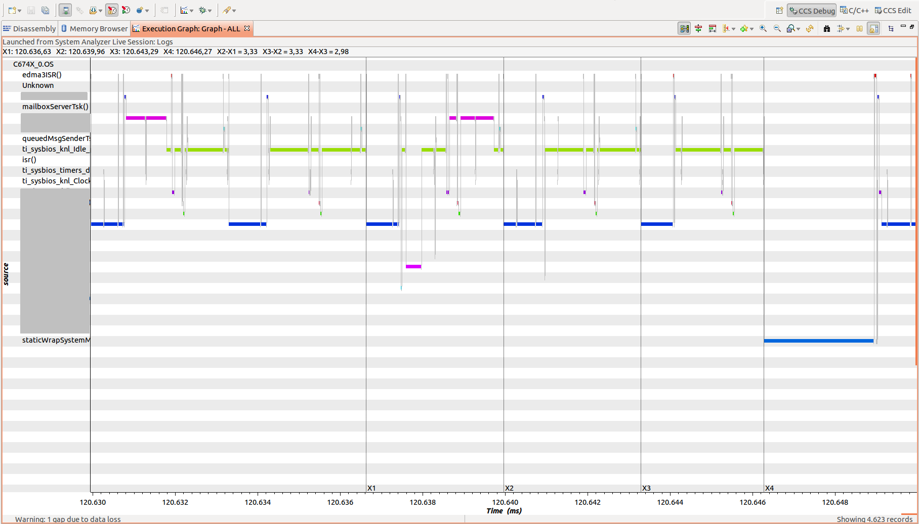

    I tried to make the Task_stat() call as little intrusive as possible by doing  the call in a SYS/Bios task, called SystemMonitor in our case, with priority 1 and no disabling of anything (HWI, SWI, Task scheduling). However, I can see on the execution graph, that the SystemMonitor is quite intrusive. Please find attached a screen-shot of the execution graph. The SystemMonitor task function is called staticWrapSystemMonitor. As you can see, as long as the SystemMonitor task is running it looks like the HWIs are disabled or at least the ISR "edmaISR" stops to run. But there is no such a HWI_disable() call in the source code.
    Any idea what can cause such a behaviour?

  • Jo,
    So you have a single Task that does nothing but calls Task_stat()?  And you think its somehow disabling interrupts?
    If I understand your CPU graph correctly, the only time the Task_stat() Task runs if there's nothing else going on in the system (Since its the lowest priority Task).  So assuming this is the case, could it simply be that there's no work going on in the system and when an EDMA isr comes in, it does go and execute that?
    Another thing to try would be to simply add the function that calls Task_stat as part of Idle Task to see if that makes any difference.
    What device are you using?  On a C6000 device you can check the GIE bit to make sure its enabled.  Its the LSB in the TSR register.

  • Hi Judah,
    We started to investigate the problem because of audio gap in the system audio output. The other blue-colored task in the exec graph is the audio task. As you can see, it is called very periodically because it has to serve a ping/pong buffer for the EDMA that transfers the audio sample via McASP into the "world". If this task isn't able to run as planed then there will appear audio gaps/errors. Furthermore the edmaISR runs quite often and there must be at least one HWI during the SystemMonitor was running. But the exec graph shows that there was no run of the edmaISR.

    We are also curios about what's going on. We checked the SYS/Bios C-code of the Task_stat() [1] again. I guess the function call you mentioned is at line 911 in in the attached file. We will gather more information and logs.
    For new I would like to provide you some more information according to the execution graph, that I posted above. During the runtime of the System Monitor task function, I'm referring to the blue bar in the exec graph, there was only one iteration of the for-loop "for (uint32_t i = 0; i < MAX_NUM_TSK; i++) {" in SystemMonitorPseudoCode.cpp. We put SYS/Bios Log_prints around all the API calls in the for-loop and we saw that nearly all the runtime, the blue bar, was consumed by the Task_stat() call. And during that time the HWIs seems to be disabled.
