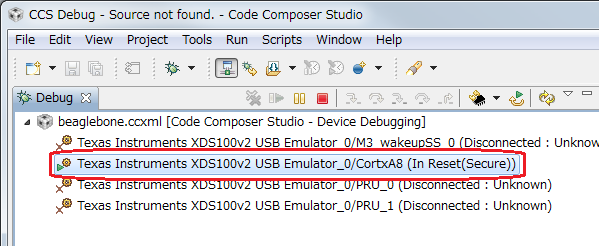

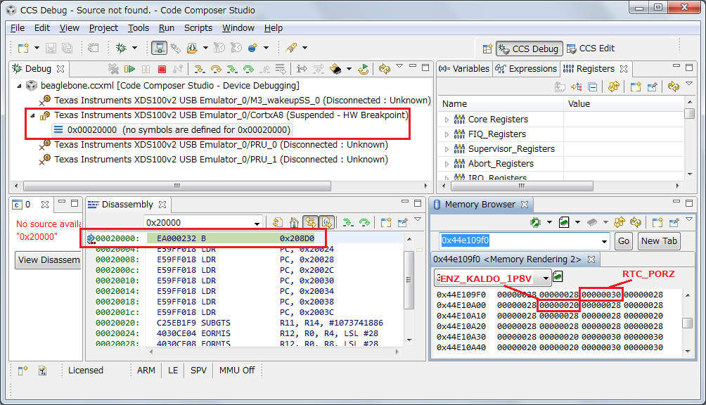

After boot, I checked conf_<module>_<pin> register.
I think terminal settings are different from datasheet.

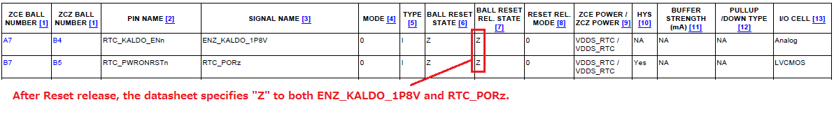

In the datasheet Table 2-7(sprs717f: P42-43):
On our checking:

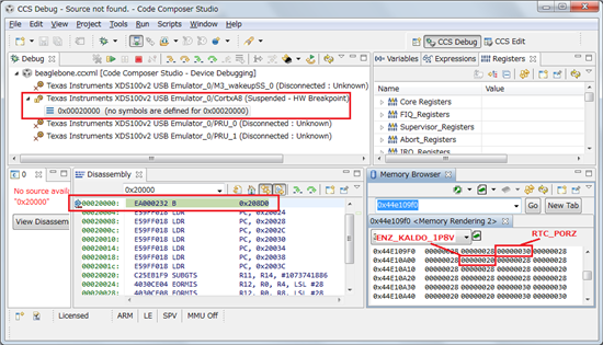

  RTC_PORZ=0x00000030       .. Pullup is enabled.
  ENZ_KALDO_1P8V=0x00000020 .. Pulldown is enabled.
Could you check them?
If they are mistakes of datasheet, can you update datasheet?
