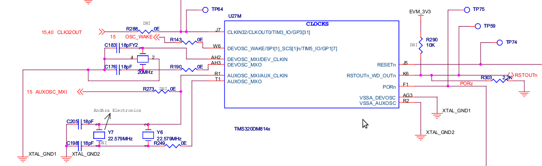

I'm using DM8148, I would like to configure and use the on-chip AUXOSC oscialltor to create 2.048 MHz or 8.192 MHz for the McBSP.

  • Hi Gilad,
    Even though you are planning to use internal oscillator, you should connect 22.579MHz external crystal on the AUXOSC_MXI and AUXOSC_MXO pins. You can not configure this 22.579MHz by software (with programming DM8148 device registers).
    Refer to the DM814x datasheet, section 7.4.1.1 Using the Internal Oscillators

  • Hi Pavel,
    Thank you for your reply.
    I still don't understand, you wrote that I must use an external crystal, but in the Technical Ref Manual (see mark in section 2.3.2 below), it writes that auxosc is on-chip oscillator.
    Moreover, I understand from section 2.3.2 of the Technical Ref Manual (see mark below) that AUXOSC has two modes:
    1. Use it as a second oscillator, generate any frequency between 20-30 MHz.
    2. Use one off-chip VCXO to supply AUXOSC reference clock, the on-chip oscillator is bypassed.
    If I must supply external crystal for AUXOSC, why does this sections writes about on-chip oscillator? why do we need bypass and VCXO, isn't using VCXO and bypass identical to using external crystal?

  • Gilad,
    We have external crystal + internal/on-chip oscillator.
    See DM814x datasheet:
    7.4.1 Device (DEV) and Auxiliary (AUX) Clock Inputs
    The device provides two clock inputs, Device (DEVOSC_MXI/DEV_CLKIN) and Auxiliary (AUXOSC_MXI/AUX_CLKIN). The Device (DEV) clock is used to generate the majority of the internal reference clocks, while the Auxiliary (AUX) clock can optionally be used as a source for the Audio and/or Video PLLs.
    The DEV and AUX clocks can be sourced in two ways:
    1. Using an external crystal in conjunction with the internal oscillator or
    2. Using an external 1.8-V LVCMOS-compatible clock input
    Note: The external crystals used with the internal oscillators must operate in fundamental parallel resonant mode only. There is no overtone support.
    When the internal oscillators are used to generate the DEV and AUX clocks, external crystals are required to be connected across the DEVOSC or AUXOSC oscillator MXI and MXO pins, along with two load capacitors
    7.4.1.2 Using a 1.8V LVCMOS-Compatible Clock Input
    A 1.8-V LVCMOS-Compatible Clock Input can be used instead of the internal oscillators as the DEV and AUX clock inputs to the system.

  • Gilad,
    Gilad Z said:
    I'm using DM8148 EVM
    Which revision of the EVM? I am using rev.D EVM with DM8148 PG2.1 device.
    As you are with EVM, you do not need to worry about the external crystal. It is already attached. You should attach it yourself, when design DM814x based custom board.

  • Gilad,
    Gilad Z said:
    How can I find which revision of EVM and device I have?
    The revision of the EVM should be printed on the EVM base board. The device PG is reported in the u-boot stage.
    Gilad Z said:
    What is the frequency of the external clock in the EVM?
    If by "external clock" you mean the clock sourced from the auxiliary crystal oscillator, the frequency on the EVM is 22.579 MHz.
    Gilad Z said:
    I'm currently using EVM, but the next step is custom board. The question - which to use, external crystal or oscillator to get the desired accuracy of clock out?
    You need a crystal oscillator. A crystal oscillator is a (external) crystal and (internal/built-in) oscillator. DM814x device has built-in oscillator circuity, so you need to add crystal. In case of EVM, Mistral has already add the crystal, and its frequency is 22.579 MHz.
