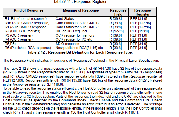

    I am porting the AM335x StarterWare MMC/SD example to C6748 and using the lowest 8 bits of MMCRSP45 for response bits 7:0 does not work. Wrong values causes the SD Card to hang.
  • Hi Norman,
    From my end, I have also checked in few versions of Davinci linux (file: "drivers/mmc/host/davinci_mmc.c" at function "mmc_davinci_cmd_done() ") and noticed exactly what you said. It leads me to the same questions. When I compared the two versions, it gives me a hint that according to the "Response type" ( i.e.., R1,R2,R3,R4,R5, R6, R1b e.t.c) and the length of the response type - 48 bits or 136 bits, the read to the number of response bits from the response registers varied. That is,  if the Response-Data-length  is 136, 120 bits are extracted from response registers and if the Response-Data-length  is 48, 32 bits are extracted from the response registers.
    When I referred to the  http://www.ti.com/lit/ug/spru765a/spru765a.pdf, it re-directed to "SD Host controller simplified specification" document. Page No: 42 explains what we are looking for. It says, only part of the response data is stored in the response registers to increase the response read efficiency by completing in one read cycle of 32-bit bus sytem and the rest will be extracted from the command registers.
    Shankari
    Please click the Verify Answer button on this post if it answers your question.
  • Okay. That makes sense for u-boot and linux. For 48 bit messages, their code must store R[39:8] in array response[0] and all bitmasks are shifted to match. The famously lack of documentation in code doesn't say as much. For 136 bit messages, their code saves last 128 bits but appear to use first 120 bits of that 128 bits. That matches the SD spec. The C6748 documentation is correct.
    The AM335x code is still a bit of a puzzle as it appears to save R[31:0] in response[0] but the bitmasks used in StarterWare appear to match the shifted masks in u-boot/linux. A straight forward match of AM335x response registers to C6748 response register doesn't seem to work.
