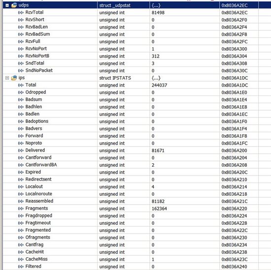

helloworld udp checksum error & recvFull issues
i'm using ccs 5.4 & evm 6678, i'm attaching the project properties of my application. Its a modifed hello world to recieve the udp braodcast packet (changed the recieve buufer size to 32K from 8K).the data Rate is 33 Mb/s and the packet size is 1498 bytes, udp data is 1456 bytes I'm getting two problems . i'm getting a lot of packet dropped because of bad udp check sum and recieve full. i'm logging the udps structure.
please help me with the problem.
i have captured the packet being sent in a wireshark parallely and verified that the check sum is correct( validation of UDP check sum is enabled in wireshark)
log.zip

  • hi Eric,
    i have checked with different packet sizes, check sum error happens when udp data size > 1430 (eth frame > 1472). below this everything seems to be fine.
    but i have recvFull even when the size of packet is reduced . i have to reduce the data rate to very low <5Mbps to correct this

  • i have checked with unicast also , it also has the same problem i mentioned in previous post.
    there is some problem with packet size > 1430 bytes.
    i also want to know the reason for recvFull.

    The Rec full was caused by the system_printf() in the code. If you remove the those code (only free the buffer there), then halt DSP and check udps.RecFull in expression window, I don't see the issue at even 100 Mbit/s. So, I can't reproduce the checksum error, for rcv full it seems not a real issue.
    Regards, Eric
  • hi Eric,
    thanks for help. i have understood recvFull is not a real issue its caused by system printf.
    i would like to know more why its causing recv full?
    my understanding is system printf sends out prints only when system has free time  so it should not effect the reception.
  • hi,
    i have tried our code i'm also geeting similar results as you told.
    i have tried something extra with it, which again created the badsum issue.
    i shall explain in detail. i found that the iperf tool sends 1470 payload every time. the packet has only a slight change in payload.
    my actual requirement will have different data every time.

    I tried your abcd.txt:
    iperf -u -c 158.218.109.165 -p 55100 -b 50m -t 1200 -F abcd.txt
    Client connecting to 158.218.109.165, UDP port 55100
    Sending 1470 byte datagrams
    UDP buffer size: 64.0 KByte (default)
    [  4] local 158.218.109.172 port 57679 connected with 158.218.109.165 port 55100
    [ ID] Interval       Transfer     Bandwidth
    [  4]  0.0-19.9 sec   114 MBytes  47.9 Mbits/sec
    [  4] Sent 81172 datagrams
    [  4] WARNING: did not receive ack of last datagram after 10 tries.
    From dsp side,
    No chksum error. From ips, you can see fragment and re-assmble for all UDP packets. Attached is the Wireshark.3386.1470_frag.rar
    Regards, Eric
