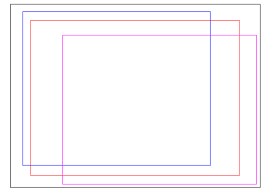

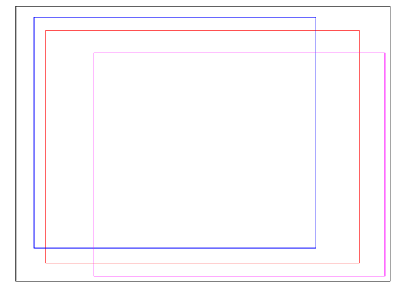

Yes this is possible. You will have to create the layout with required swmsPrm.layoutPrm such that the windows overlap. You should take care of couple of things:
1. Use only one scaler in Swms.
2. The window that you want visible (upper layer) should have higher window number compared to lower layer

You can use 2 scaler in swms .This is already supported .Refer multich_vdec_vdis.c usecase where multiple scalers are used. You cant use multiple scalers if you are using PIP layout where one video window is overlayed over another video window than you can use only one scaler.
Are you sure you have 24 windows in PIP layout. You cant use multiple scalers _only_ in PIP layout. When yu switch to some other layout you canuse multiple scalers. The swms has API to dynamically map scaler to input channel.
Two scalers cannot be used in PIP because if two scalers are used the ordering of one window above the other window cannot be achieved.
