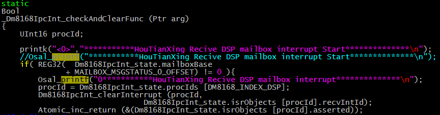

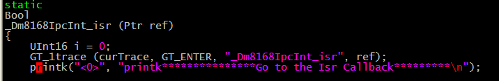

    I find the callback function is the _Dm8168IpcInt_isr (Ptr ref), and the function _Dm8168IpcInt_checkAndClearFunc (Ptr arg). And I add the "Osal_printf" and "printk" in the functions as follow:
    However, it print nothing in the terminal.
    I do that to test and verify the interrupt to be executed.
  • I guess printk will not output to console directly. It dumps all prints in to a kernel allocated buffer. Can you try running 'dmesg' command on the console after these functions are executed.

    If you are specifically using syslink Notify for your own application then only look at OsalIsr.c. If you are manually writing to a mailbox from DSP side first please confirm which Notify you are using from A8 (kernel or syslink) and then put prints in callback accordingly (in notify_shmdrv_dsp_isr or_Dm8168IpcInt_checkAndClearFunc)
