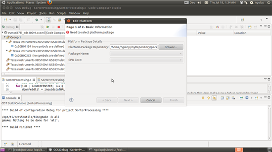

  • Hi Chad
    thank you for Reply . how I can acess the Platform Configuration Tools to edit the Platform : I go to Tools->RTSC->Platform->Edit/View . and I get this Fenster :
    The Fied Package name and CPU Core are not activ.
    Using the openMP Hello World the Platform configuration look like this :
    http://e2e.ti.com/support/dsp/c6000_multi-core_dsps/f/639/t/265543.aspx?pi168778=3
    so I don´t no how I can get this Fenster to manage my memorx Sections
    Best Regards
    Lopez
