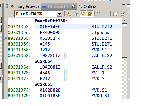

    - Then at NIMU driver layer, did you see EmacRxPktISR() function hit? You can set a breakpoint in assmbly window.
       Wold you please point to me that how should I set this breakpoint? since I never go into the NIMU layer. Any detailed instruction will be appreciated.

  • Fan,
    - It is table 3-3 in SPRUGV9D—June 2013.
    - Set break point, see attcahed picture

    and go nowhere else. I put a breakpoint in function EmacRxPktISR(). it doesn't intercept the program when hanging.
