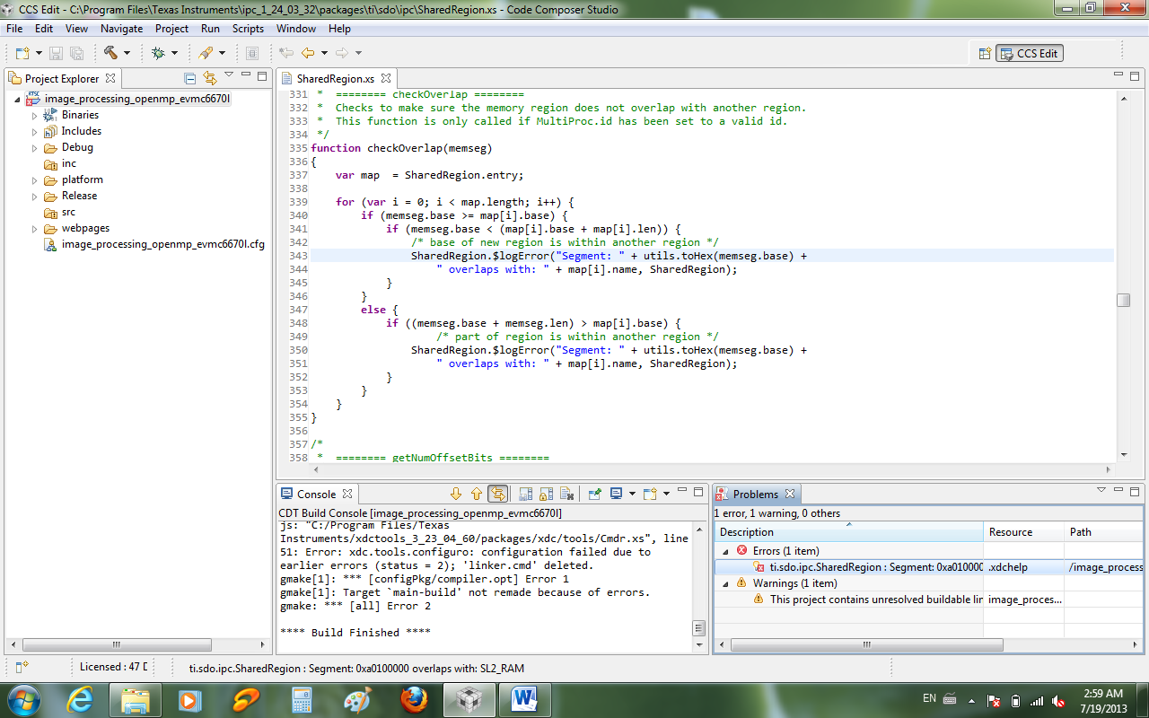

I'm using the image processing program openMP  project will run on a c6670 EVM.
Demo program runs correctly. But when I build the project, i see an error:
ti.sdo.ipc.SharedRegion : Segment: 0xa0100000 overlaps with: SL2_RAM          .xdchelp            /image_processing_openmp_evmc6670l          line 367 C/C++ Problem
**** Build of configuration Debug for project image_processing_openmp_evmc6670l ****
"C:\\ti\\ccsv5\\utils\\bin\\gmake" -k all
'Webpage Convert'
C:/ti/ccsv5/utils/gmake/gmake -C ../webpages/tool/php -j 4
process_begin: CreateProcess(NULL, C:/ti/ccsv5/utils/gmake/gmake -C ../webpages/tool/php -j 4, ...) failed.
make (e=2): The system cannot find the file specified.
gmake[1]: [pre-build] Error 2 (ignored)
'Building file: ../image_processing_openmp_evmc6670l.cfg'
'Invoking: XDCtools'
"C:/Program Files/Texas Instruments/xdctools_3_23_04_60/xs" --xdcpath="C:/ti/bios_6_35_03_47/packages;C:/Program Files/Texas Instruments/imglib_c66x_3_1_1_0/packages;C:/Program Files/Texas Instruments/omp_1_02_00_05/packages;C:/Program Files/Texas Instruments/ipc_1_25_03_15/packages;C:/Program Files/Texas Instruments/pdk_C6670_1_1_2_6/packages;C:/Program Files/Texas Instruments/ndk_2_22_03_20/packages;C:/Program Files/Texas Instruments/mcsdk_2_01_02_06;C:/Program Files/Texas Instruments/mcsdk_2_01_02_06/demos;C:/ti/ccsv5/ccs_base;" xdc.tools.configuro -o configPkg -t ti.targets.elf.C66 -p demos.image_processing.openmp.evmc6670l.platform -r debug -b "C:/Users/neon/workspace_v5_4 op/image_processing_openmp_evmc6670l/platform/config.bld" -c "C:/ti/ccsv5/tools/compiler/c6000_7.4.2" --compileOptions "--gcc" "../image_processing_openmp_evmc6670l.cfg"
making package.mak (because of package.bld) ...
generating interfaces for package configPkg (because package/package.xdc.inc is older than package.xdc) ...
configuring image_processing_openmp_evmc6670l.xe66 from package/cfg/image_processing_openmp_evmc6670l_pe66.cfg ...
error: ti.sdo.ipc.SharedRegion: "C:/Program Files/Texas Instruments/ipc_1_25_03_15/packages/ti/sdo/ipc/SharedRegion.xs", line 367: ti.sdo.ipc.SharedRegion : Segment: 0xa0100000 overlaps with: SL2_RAM
js: "C:/Program Files/Texas Instruments/xdctools_3_23_04_60/packages/xdc/cfg/Main.xs", line 149: Error: Configuration failed!
gmake.exe: *** [package/cfg/image_processing_openmp_evmc6670l_pe66.xdl] Error 1
js: "C:/Program Files/Texas Instruments/xdctools_3_23_04_60/packages/xdc/tools/Cmdr.xs", line 51: Error: xdc.tools.configuro: configuration failed due to earlier errors (status = 2); 'linker.cmd' deleted.
gmake[1]: *** [configPkg/compiler.opt] Error 1
gmake[1]: Target `main-build' not remade because of errors.
gmake: *** [all] Error 2
**** Build Finished ****
How do I edit this demo project and  I use this program?

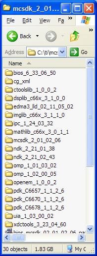

Ccs v5.4:
Ipc 1.25.3.15
Mcsdk 1.1.2.6
Ndk 2.22.3.20
Sys/bios 6.35.3.47
Uia 1.3.1.08

  • Hi Amin
    I just imported the project in my setup and was able to build successfully. The build log is below.
    Looks like a memory map conflict in your build. I notice that you are using newer versions of some tools than what was provided with MCSDK 2.1.2.6. This might be causing the memory conflict (I think IPC in particular). Please go to your project properties and under the RTSC tab select version numbers for IPC, BIOS, etc. based on what came with the MCSDK 2.1.2.6 installation. I have attached a snapshot of my folder structure so you can identify the version numbers that come with this release and select them in your project properties. Also please change your compiler version to 7.4.0 as per the MCSDK release notes.

  • Hi Uday
    Thank you for your Reply. I did a reset as you suggested. (RTSC change). But I see the same error again. I have attached the .map and .cfg files of this project.

  • Amin,
    From your snapshot I see that in your Project Explorer view, the folders 'src' and 'inc' have an exclamation mark on them, which means that it cannot find those folders. Could you please right click on the respective folders and in Properties modify the path so that it can resolve the required source and header files? Once you do that do 'clean project' and then 'build project' and report back with the console log that you see.
  • Uday,
    Thanks for your help. I was able to make the .out file. .out file of demo works correctly. But, .out file made ​​by me will not work correctly.

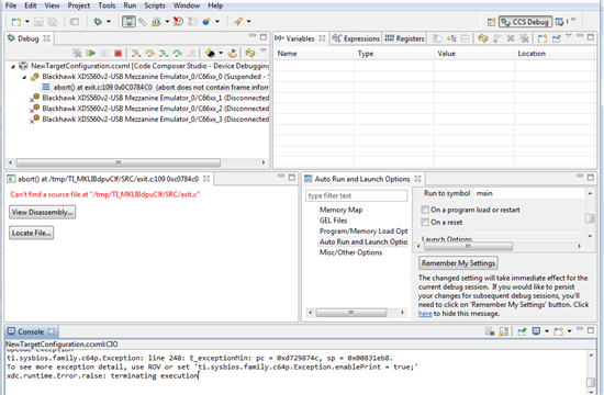

    Exception at 0xd729874c
    EFR=0x2 NRP=0xd729874c
    Internal exception: IERR=0x8
    Opcode exception
    ti.sysbios.family.c64p.Exception: line 248: E_exceptionMin: pc = 0xd729874c, sp = 0x00831eb8.
    To see more exception detail, use ROV or set 'ti.sysbios.family.c64p.Exception.enablePrint = true;'
    xdc.runtime.Error.raise: terminating execution
  • Amin,
    Could you please make sure you are doing the following before loading the .out file?
    1. Launch your target configuration for your 6678 EVM in CCS Debug perspective
    2. 'Connect Target'
    3. Now for each core, select the core, go to Tools--> Debugger Options --> Generic Debugger Options. This should bring up a window. Under 'Auto Run Options" uncheck the box that says, 'On a program load or restart.'
    4. After completing step 3 for all cores, click on 'Remember my settings'
    5. Now load your .out file on the cores. After loading is completed, cores should be in suspend mode, and at the symbol __c_int00().
    6. Now run thecores
    Please let us know if this resolves your issue
  • Uday,
    I did all the steps but still the same error message there.
  • Uday,
    image of error message:
    Thanks.

  • Are you using compiler version 7.4.0 or 7.4.2?
  • compiler version 7.4.0
  • OK that's the right one. Could you please zip and attach your project here. I'd like to do a quick check on my setup here.
