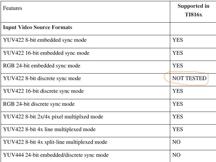

does 8168 support 8-bit discrete sync mode?
in 'HDVPSS_UserGuide.pdf':
my modules output bt.656, when i test embedded sync(720p60), it wors well.
but after change the module config to discrete hsync/vsync(33.75k, 30HZ), 150M, output 1080p30, the video stop after 1second, and show:
[m3vpss ] 1720083: CAPTURE: Overflow detected on VIP0, Total Resets = 1
[m3vpss ] 1720083: CAPTURE: Overflow detected on VIP0, Total Resets = 2
[m3vpss ] 1720083: CAPTURE: Overflow detected on VIP0, Total Resets = 3
[m3vpss ] 1720083: CAPTURE: Overflow detected on VIP0, Total Resets = ......
the decode also stop.
OMAP chip is TI8168 2.1, sdk is dvrrdk-3.5
and i want know where is the capture source code, how to print SAV/EAV in vpss(embeded sync)?
