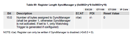

    Most likely SM2 is still configured for old length value. Did you adjust SM2 and SM3 size as well in ESI XML to reflect the above change?
    <Sm DefaultSize="5" StartAddress="#x1800" ControlByte="#x64" Enable="1">Outputs</Sm>
    <Sm DefaultSize="7" StartAddress="#x1c00" ControlByte="#x20" Enable="1">Inputs</Sm>
  • Yes, I have modified the ESI XML file.
    <Sm DefaultSize="1" StartAddress="#x1800" ControlByte="#x64" Enable="1">Outputs</Sm>
    <Sm DefaultSize="1" StartAddress="#x1c00" ControlByte="#x20" Enable="1">Inputs</Sm>
    And also adjust the elements of Process data object in XML file.
    Louis
    Can you success modify the TI_ESC to only have 8 of digital inputs and 8 of digital outputs?
    Louis
    No - we can't either. This is complying behavior to ESC register spec from Beckhoff - you can't have an SM activated if length <= 1. So you must configure minimum 2 byte length for digital I/O.
    I will clarify this in our register documentation -  I agree that WD trigger not generated when length is set to 1 is a minor variation from spec.

    I feel some doubts for this sentence, It not identical with the register description.
    1. So if I just want to have eight bits of DI and eight bits of DO, have any suggestion to implement this?
    2. Do you know why the EtherCAT spec. to define SM Length which shall be greater 1 ?

  • Louis,
    Just don't use the second byte of a 16 bit transfer.
    Most likely HW related. But you better ask Beckhoff for that.
    Regards.
  • > So if I just want to have eight bits of DI and eight bits of DO, have any suggestion to implement this?
    Add a dummy byte
    Looks tied to SM implementation in Beckhoff h/w as for SM operation distinction between first byte and last byte might be necessary to lock/unlock a buffer.
