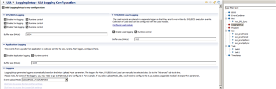

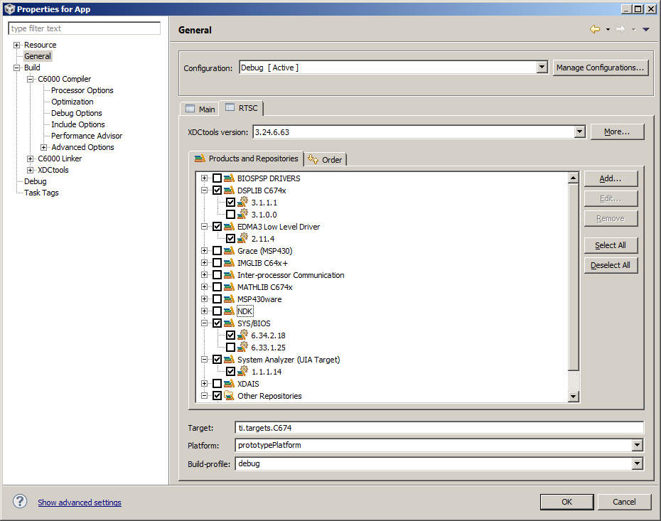

1) I included "System Analyzer (UIA Target)" in Project->Properties->General->RTSC.

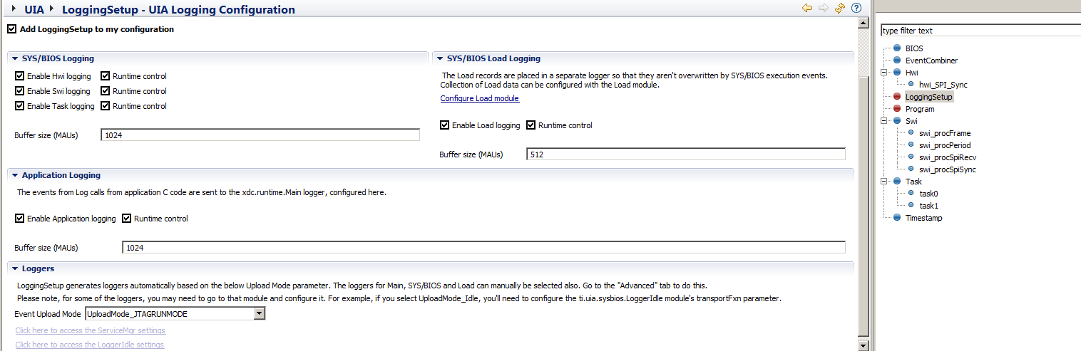

2) I added module "LoggingSetup" using UI tool (XGCONF). Manual tells all needed for me options must be configured by default (CPU Load).
3) a) However I changed to UploadMode_JTAGRUNMODE. But it didn't work for UploadMode_JTAGSTOPMODE too.
    b) I have setup SYS/BIOS library type to "Custom" with Asserts and Logs set to OFF.

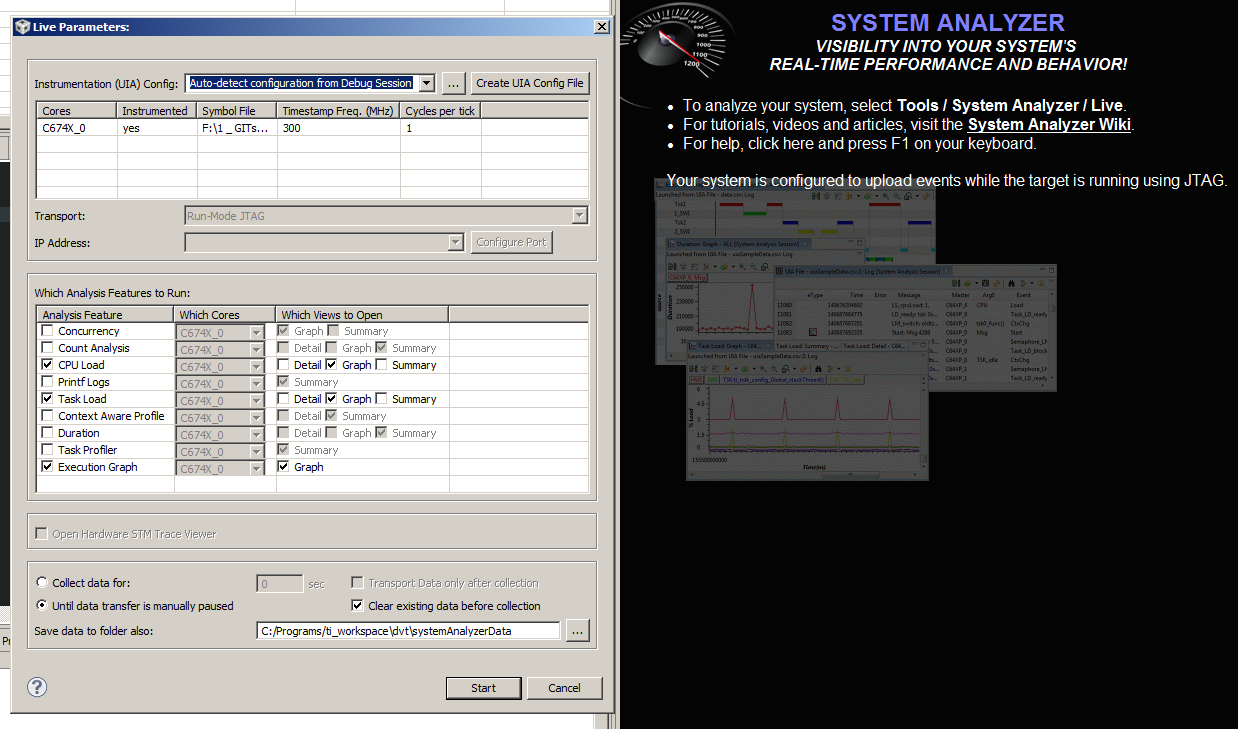

THEN, it is successfully built, when running app - System Analyzer Welcome screen and Menu Entries tell everything is OK, but I can't receive anything. No any data. Empty white graph windows forever.
Tries to play with manual options for "Load module", "LoggerCircBuff" - no any result.
What am I doing wrong?
