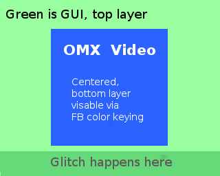

On our  boards, we're driving /dev/fb1 to a VGA monitor on DVO2, at 1280x1024 (60Hz). We see that periodically (once or twice within 1 minute), the display image "glitches" -- it's as if a display frame buffer is momentarily off by some number of row/columns.  We are also driving the HDMI (/dev/fb0) and SD (/dev/fb2) simultaneously, but see no issues on those displays. Aside from the recurring "glitch," the video out DVO2 looks great.
It *seems* like this glitch only occurs while the OpenMax video pipeline is running... I don't seem to see "glitches" on the GUI if the OpenMax application isn't running.

    Correction: After reviewing my notes, I remembered I had reproduced this with a simpler use case-- please ignore the crossed out portion above and refer to the configuration in my original post.
    As you'll see from my first post, I had simplified my use case to only drive the GUI to /dev/fb1, and made the dimensions of /dev/fb1 the full VGA display resolution. I did this to rule out any concerns that I was doing something strange from the GUI & Linux Framebuffer device side of things.
    The video output is the only thing on the SD2 display.
    To reiterate, I *only* see an intermittent "glitch" in the VGA display output when all of this is running at once. It does *not* occur:
    • When running only the GUIs on the framebuffer devices
    • When only running the OMX pipeline
    The "glitch" appears as maybe 20-40 rows of torn VGA display data, and it always occurs in the same spot, at the bottom of the GUI (which is overlaid atop the OpenMax video.)

    The symptoms of the glitch aren't appearing in the video from OMX pipeline, but on the GUI layer that's overlaid atop of the video. As there's not really any movement in the GUI, I can't say with certainty just yet if I'm seeing data from a previous frame.
    As described in my earlier post, our configuration looks like this:
    The video is from our OMX pipeline, and the GUI is atop the video layer, using color keying transparency to make the lower video layer visible.
    When the glitch occurs, it only corrupts a region of the GUI, as shown above by the dark green. It's hard to tell, as it happens so quickly, but I think a row is becoming shifted and wrapping around -- I see some text wrap and the position of some GUI widgets shift.
    However, when this glitch appears, I don't see any noticeable change in the OMX video stream.
    I do not believe it's an issue with the GUI data being corrupted, as I'm able to clone the data to both /dev/fb0 and /dev/fb1 -- the data on dev/fb0 looks fine, while /dev/fb1 glitches.   If I remember correctly, I've also tried switching them; the problem follows the VGA output.
    As mentioned in my above posts, this seems to occur when I have both my GUI and OMX stream running. I don't see anything anything out of the ordinary on the HDMI, VGA, or SD outputs when running just one.
