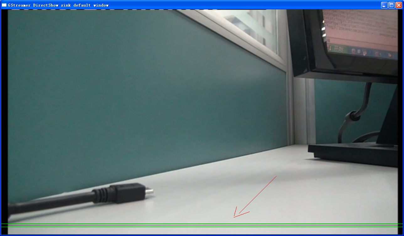

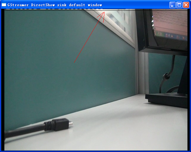

      But when I resized video resolution and I found there are some black or green lines in my video as follow:
Resize to VGA:
 gst-launch -v v4l2src device=/dev/video2 !\
ffmpegcolorspace ! videoscale! videorate ! \
video/x-raw-yuv,format=\(fourcc\)UYVY, width=640, height=480, framerate=25/1!\
TIVidenc1 rateControlPreset=3 codecName=h264enc engineName=codecServer !\
rtph264pay pt=96 ! udpsink host=192.168.2.25 port=9000 sync=false async=false
and resize to 720P there are some green lines in the bottom.
video/x-raw-yuv,format=\(fourcc\)UYVY, width=1280, height=720, framerate=25/1!\

    I did not understand why you has sync=false and async=false simultaneously . Could you try to play the encoded video playback on PC  to check are you still observing this problem. Also could you try to decoded it on the board. It is not clear where you are observing this problem but I see you has video streaming so my guess is you see it on PC. Also could you check what is the supported resolution by your tvp and the hw/sw restriction about the resolution.Could you try with 1280x800 and let me know the result.

    I record a video and played on PC but the problem continue.
