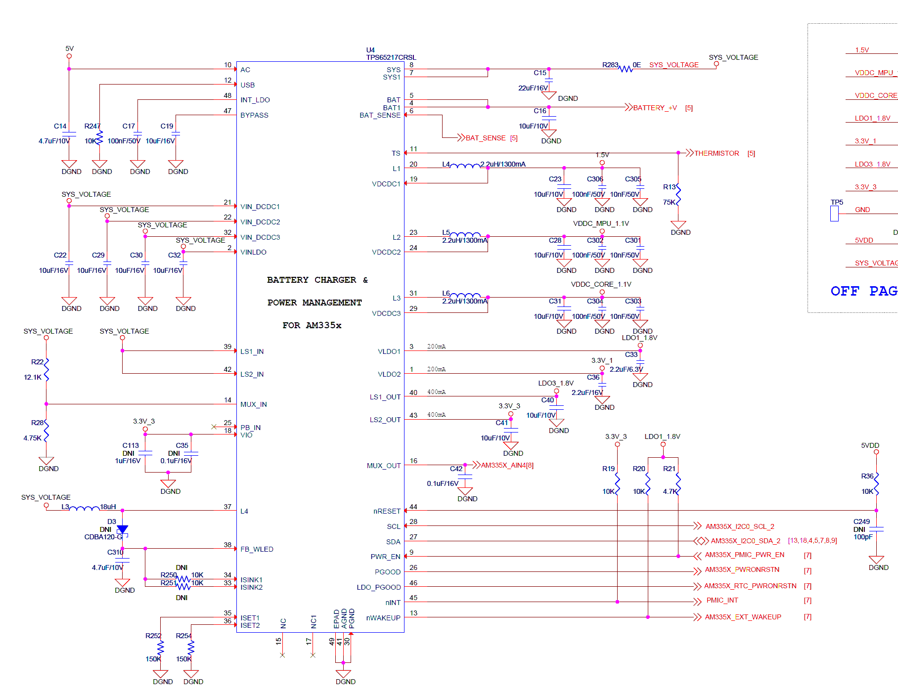

dear sir,
In my design we are using AM335x processor and TPS65217C Pmic.
in second proto of my design some boards have power issue problem.
SYS_Voltage getting down to 1.5-2.5 voltage in with in 500ms. i have checked all signal with respect to sys_voltage.
 my observation was that power_en & ldo1 follows sys_volt.
sys volt goes down first and then power_en , ldo1 , PGOOD , LDOPGOOD  goes down .

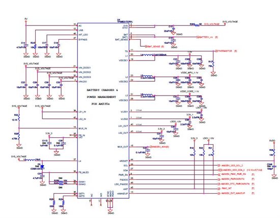

pmic configuration as per below ckt.
please suggest any sollution for this design issue.
