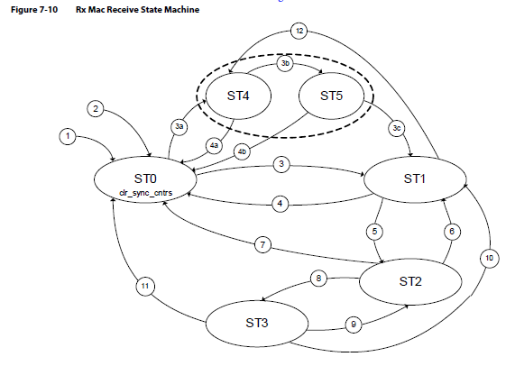

But ,when we use link3 to communicate with FPGA2 using backboard,the synchronous status of RX is 0x220, which is in the status of asking for ack.
According to the standard of OBSAI,after I  have transmitted  the seed, the fpga 2 could captured the seed and transfered ack,then the status machine could jump correctly.
But after I use the code make link3 to change for  link0 ,the scramber seed transmmitted by DSP can't be captuerd .

    according to the OBSAI ,just as the picture:
    I log the status of RX it ever jumped from wait  for seed ,and then keep waiting for ack from fpga
    now only did fpga receive the crambler seed from DSP,fpga transmiitte ack to dsp
    but ,fpga can't capture the seed ,could you tell me why?
    Enable tx ,enable scrambler ,if the clock is correct, the seed should be sent correctly ,right?
    Is there some other reason which could cause the seed not to be sent ?
    Or is there some status to show the completion  of sending seed from DSP?
